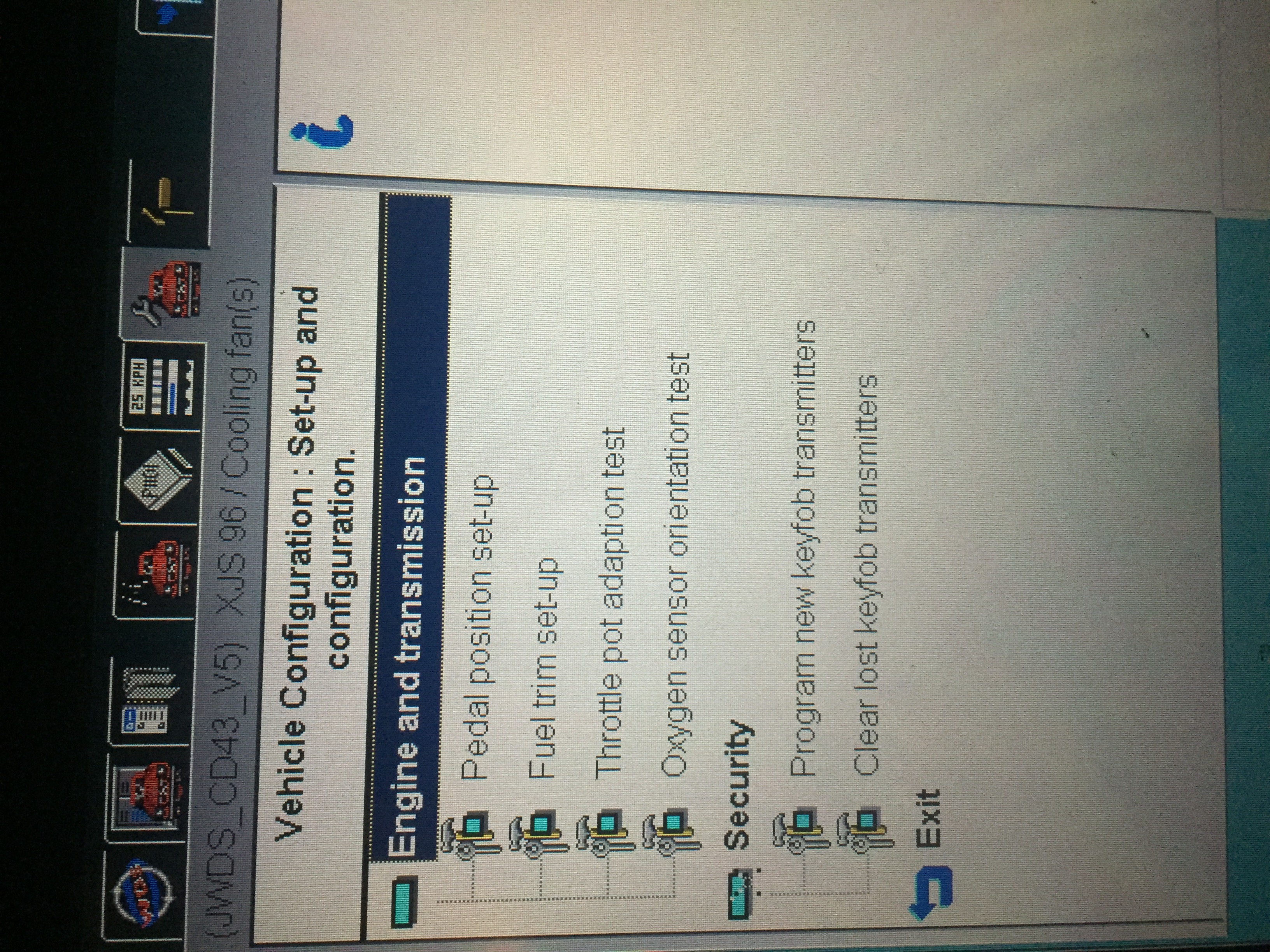

Wanted to let the forum know that I have a working WDS and I believe I can confirm that it can indeed reset the fuel trim adaptations. I haven't tried it...well, because I've finally chased down all the issues that caused the trims to get up to the +7-10 range. It is now down below +3.
I'll probably give it a shot for the hell of it though. I've attached a photo of the glorious screen that gives me access to a part I always thought only a PDU could do!
I also want to share, and correct a rumor that the Genrad GDS500, and probably GDS510, can also reset these adaptations...it cannot. I have access to the GDS500e, and it's basically a big code reader that can pull Jaguar specific codes. It may be more useful for newer models, but it has very limited abilities for the XJS.

Congrats on getting a WDS set up.
From your screenshot, it looks to be exactly the same functions as the IDS V118 like we discussed before? https://www.jaguarforums.com/forum/x...c-tool-171090/

Damn you Cambo! Raining on my parade like that.
I have to admit, I wasn't thrilled to see anything other than "Reset Base Adaptations"...I'm concerned that my option is not the same thing.
Only one way to find out...
Stay tuned.

Dagnabbit! In order to perform the fuel Trim setup I need to warm up the engine and provide some information from an exhaust sensor....
It's exactly what the sometimes working Mongoose with IDS let me do.
I have to figure out what this does.

Can you take some screenshots? Would help to understand the requirements here.
I guess it needs some sort of air-fuel-ratio or lambda measurement in order that you adjust the fuel trims to get it "right".

I basically got here one time before with the Mongoose... It specifically asks to insert the carbon monoxide probe. (I don't believe it expects you to plug anything into the WDS) I aborted at that time. If I remember correctly, it will want me to input a carbon monoxide reading, either by percentage or ppm. I was afraid if I took it to the next step, I might not be able to abort again.
I know it wants a reading at idle, I can't recall if it wants readings with the engine turning at a certain RPM as well.
