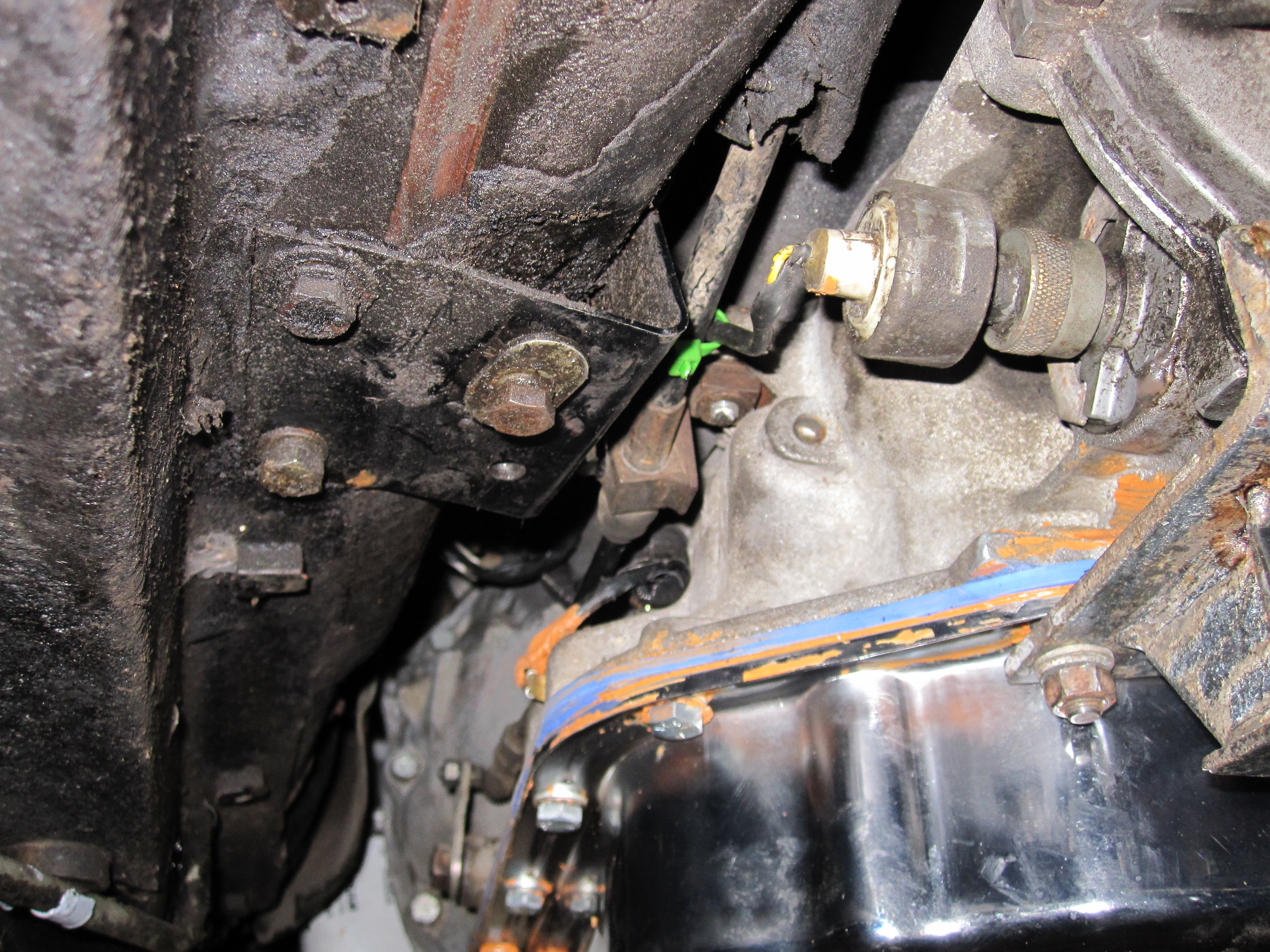

#56
Brad,
Do not get discouraged, just take your time and go slow and you will have a reliable car to enjoy, and the compliments from people will swell your head. First year I bought mine, I drove it for 4 months and then garaged it for the year. removed the interior and checked the electrics there, did have a couple of wires slightly nibbled on by a mouse, but not completely thru the insulation. But I did tape them and also cleaned all connections, then put it all back together for some driving when spring arrived,
After 3 break downs the following year, I said that's it, and garaged it and went thru All electrics under the hood/bonnet from bulk head forward as well as pulling the rad, a/c condenser and oil cooler. The wireing I strpped the insulation and check every inch(cm for you foreigners LOL). cleaned all connectors and replace the ones that I had doubts about or knew were loose. luckily my wiring was in good shape and had only a couple of places that the insulation was cracked but taping took care of that. I also had to replace a few parts, I decided at that time since I was doing it to to it right, replaced ALL rubber fuel lines under the hood and in the trunk, new cooling lines and vacuum line. I worked many night on it, and 3 years later I am sure of it running right and being dependable. And I am on a Veterans Disability, so if I can do it, you can do it
I have some pictures of the work in my photo album area of my profile
