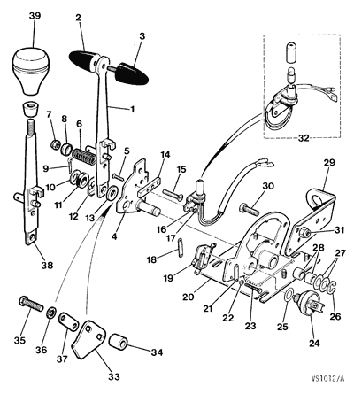

Here ya go.
#24 in this parts drawing.
RH side of the gearlever unit.

When you actually get to the switch you'll see that it's a ball-type thingy. The ball get pressed into a socket to make contact. I've had a couple stuck that required nothing more than a spritz of [insert name your favorite aerosol lubricant here]

The switch is adjustable between two nuts on its threaded centre. It has probably just come out of adjustment. IIRC, you only have to remove the ski slope, not the entire console to adjust it.

The switch is on the left side; just level with the R.
