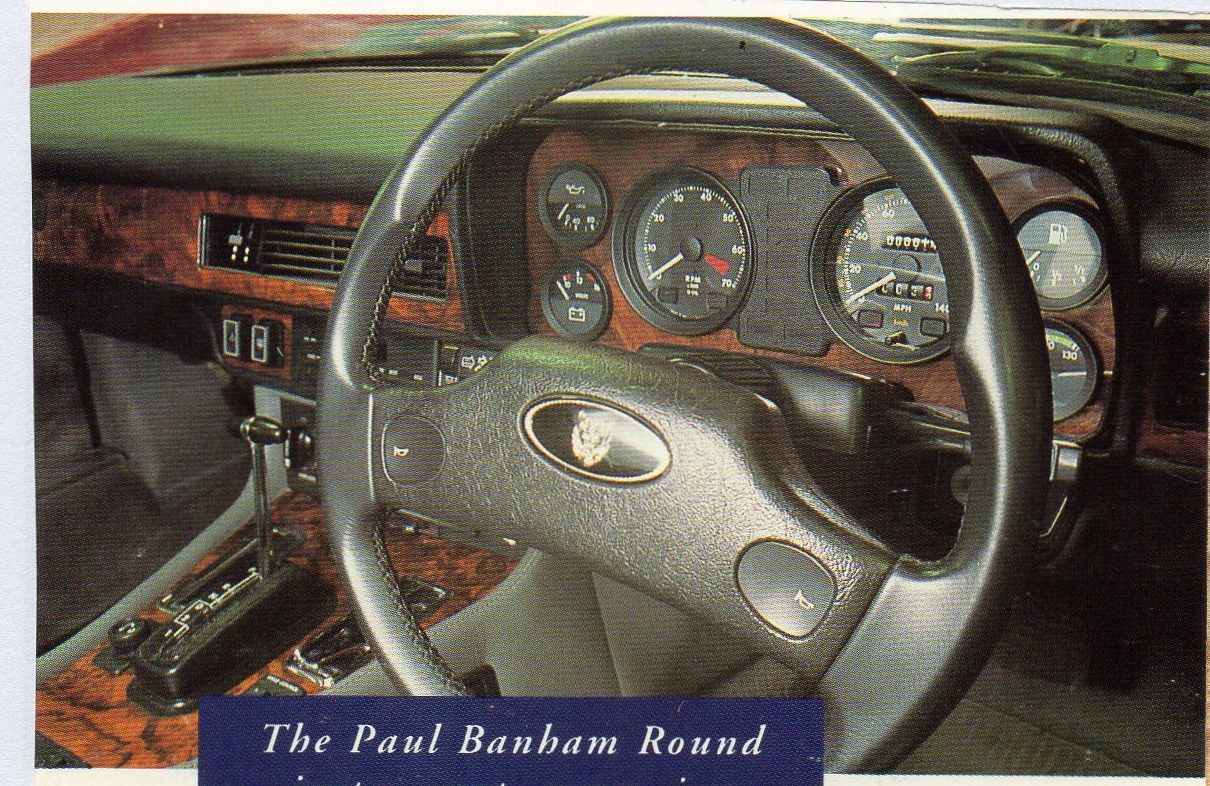

I got mine in about 1998 but it has gone throu a few incarnations with instruments and style, I finished up with new series 3 speedo and rev counter as its the only option there is if you want to see the indicator warning light, straight swap on an 84 all electronic

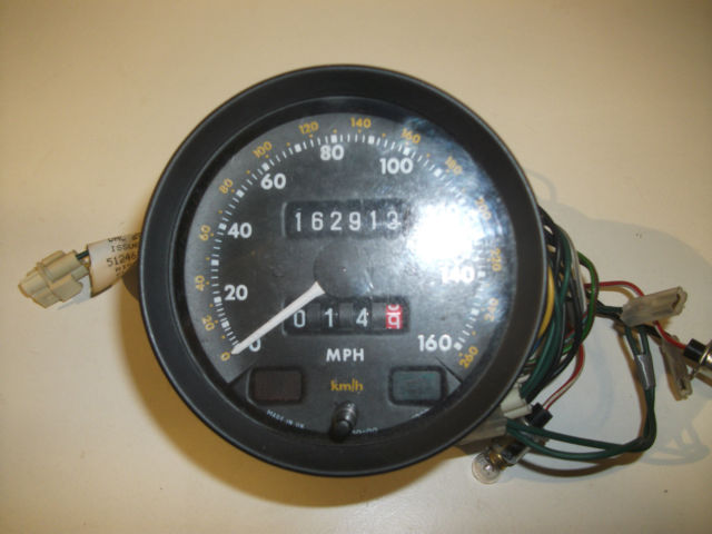

At £200 you wont get instruments as that's going to be £200 just for the 2" smiths ones.
+ speedo and rev counter from a series 3, but you should get the necessary wiring to plug in to your existing instrument wiring. here is a picture of the type of instruments you will need,

Series111 160 mph speedo rev counter and smith 2" supplementary instruments had wiring and plugs going to them (or the ones for this job do) they would all have to be spliced into the xjs harness. As myrtle will no longer supply the socket they used to make. You would also need a stabilizer for 2 of them. the ones I used were these, pic is before it was refurbed and zero'd

The smiths gauges are 10 volt so it stops them flickering about without it they would over estimate. Its quite an obtainable cheap thing all these slow moving gauges have stabilizer. That 140 mph speedo and rev counter look like xj6 and may not be good in a v12 though. Look ok in green leds
