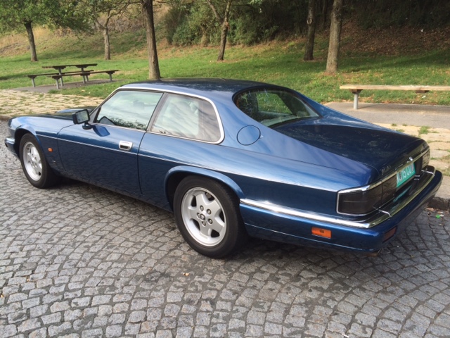

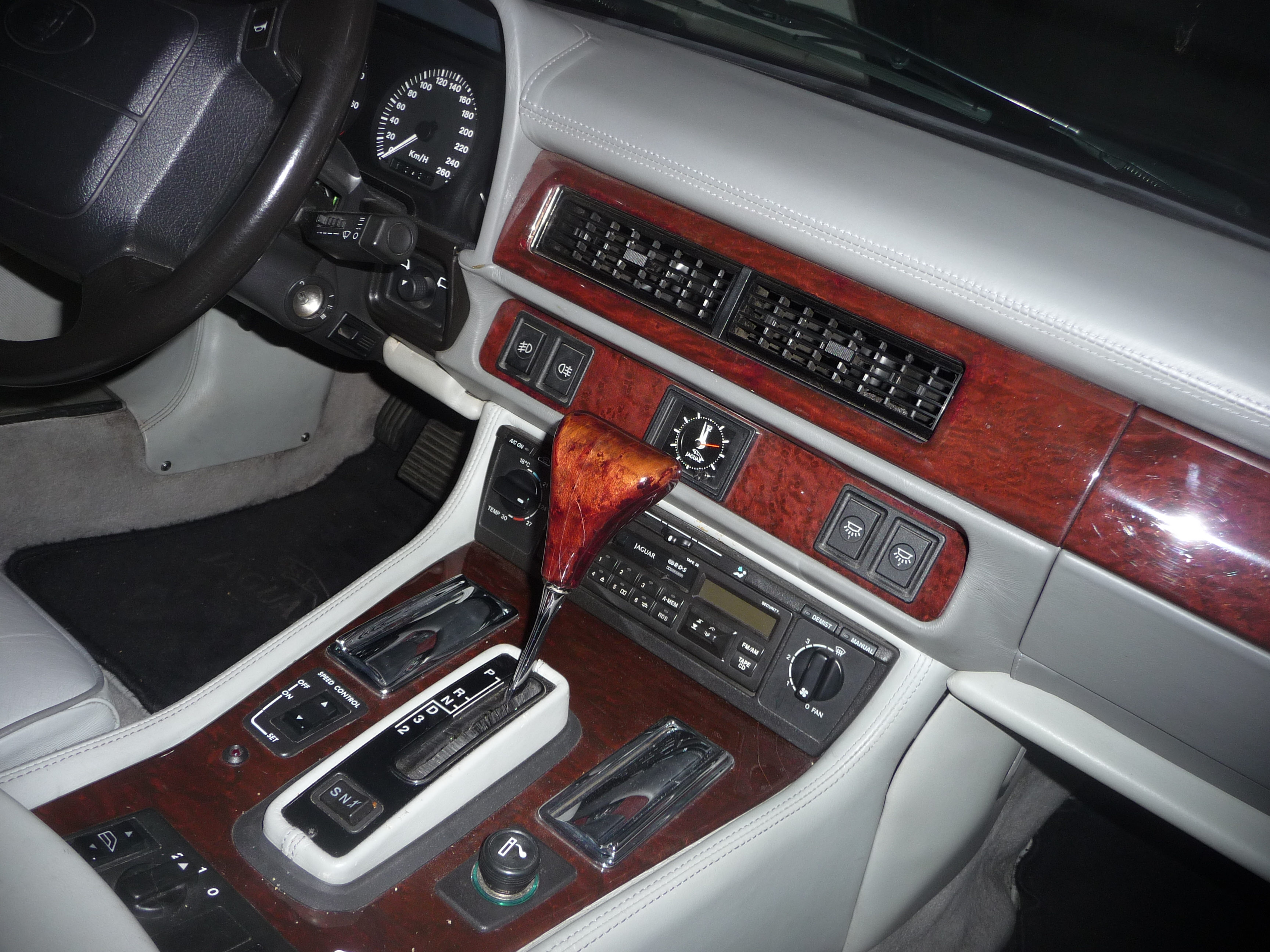

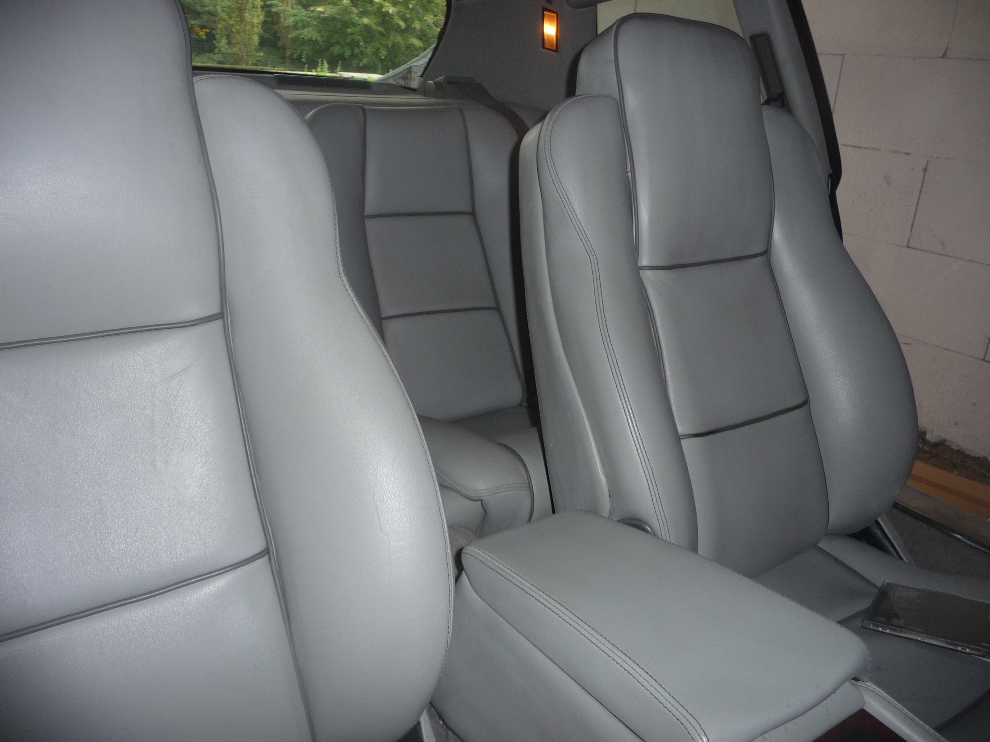

An Insignia usually has distinctive emblems on the front fenders.
Then, trim was very much up to the order as it was bespoke.
Usually, it had specific colours and was fully trimmed with Autolux leather:
Here are a few pics of my Insignia, a Coupé 4.0 of 1994, Amethist blue with pale stone leather and dark stone piping.
Attached Thumbnails Rubbing noise in rear-p1100662.jpg   Rubbing noise in rear-insignia2.jpg   Rubbing noise in rear-p1090819.jpg   Rubbing noise in rear-p1090957.jpg
Your Car looks Amazing!
Especially the Interior, which really has the Wow Factor!
So now we know what to look out for in the future.

Are the rear seats functional ?

From: Albuquerque, NM
I like the seats also in my car and my original intent was to do a rear seat delete, put a cubby box in (that I have already gotten) and make it into a two seater. Those seats look so neat, however, I am having second thoughts about that. If it turns out to really be an "Insignia" (which I really doubt) I will leave it as is.
