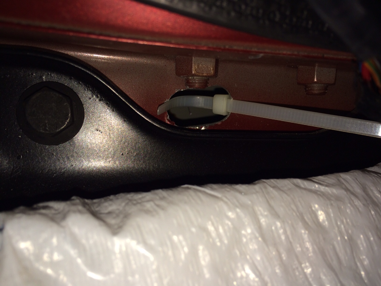

Sorry bringing back a old thread. I have a 94 convertible I'm in the process of doing the same amp install and can't figure out how to get my rca's and speaker cables to the trunk. Could someone post a pic of the location they drilled? I need 4 pair speaker wires and a 6 channel rca cable to pass through. What route did you also take the cables from the headunit back? Thanks.

I did it. I have a zip tie passed through ready to pull the wires.

I ran wires from the trunk through the drivers side upper corner of the trunk into the quarterglass pocket, then down under the panel, into the sill plate pocket up to the front of the car.
You should have a grommet there that you can pass wires through. No drilling.
I'll send you a pic tomorrow?
