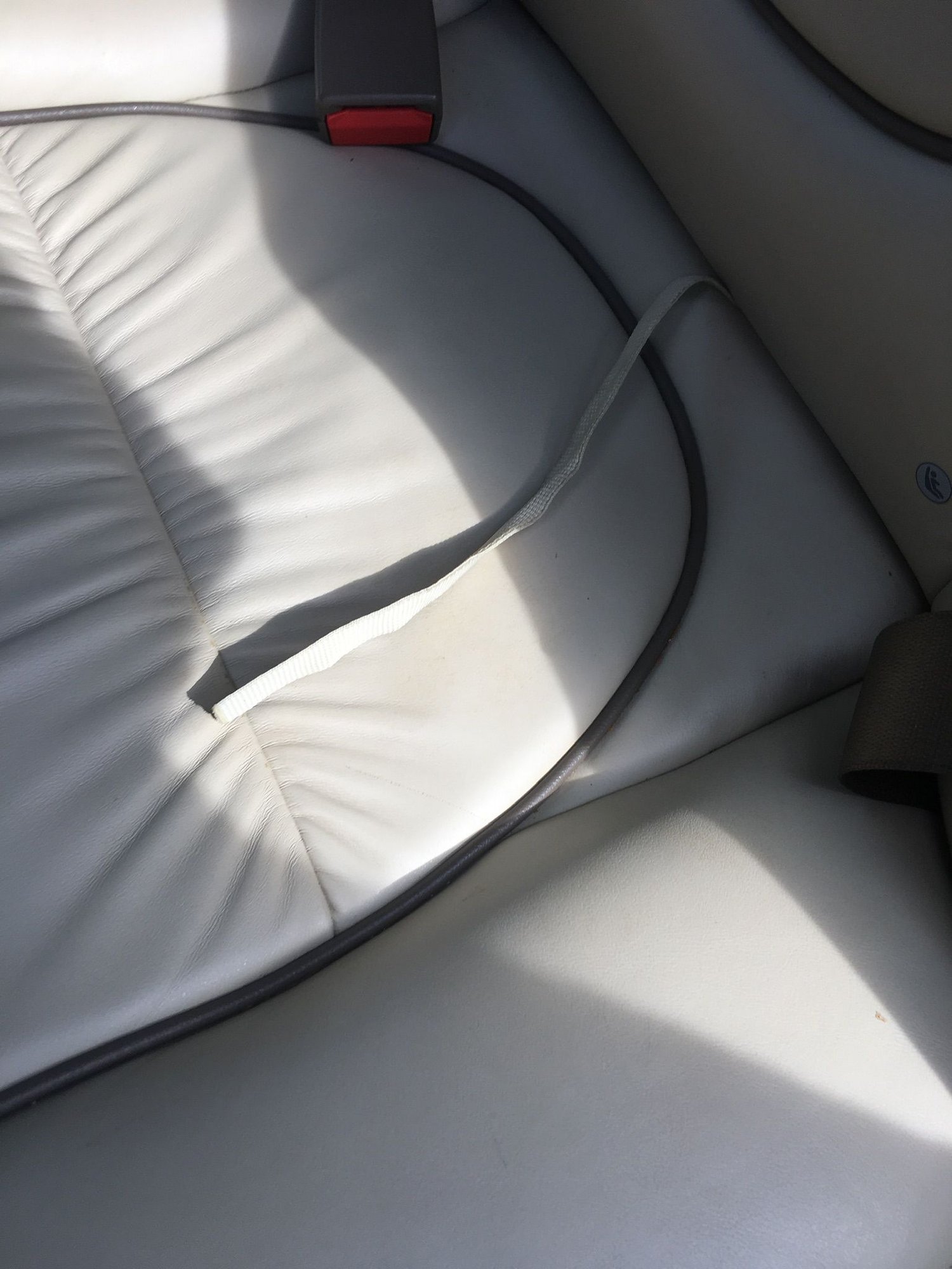

GOT IT! Very cool. There is a pull cord tucked between the back and seat cushion on each side of the XJ8L X358 jaguar releasing the back seat cushion. Now just need to figure snaking wire into truck. There seems to be many options.

Mmmm, well I can easily remove my back seat cushions. No issue at all. But then find a hole to go to the trunk. I'm checking this with my 1999 XKR...
