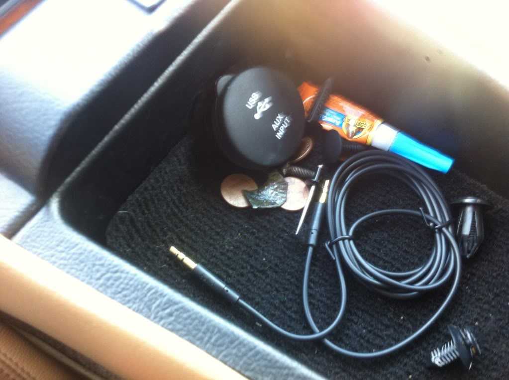

I was completely against changing the stock radio for a while, but the benefit of Bluetooth, Sirius XM, having USB AND Aux ports for passanger and being able to talk on the phone handless thru the system ended up outweighing the desire to keep the original look . If you are interested in those amenities nothing else other than replacing the stock radio will do. I got an alpine CDHD 149BT
