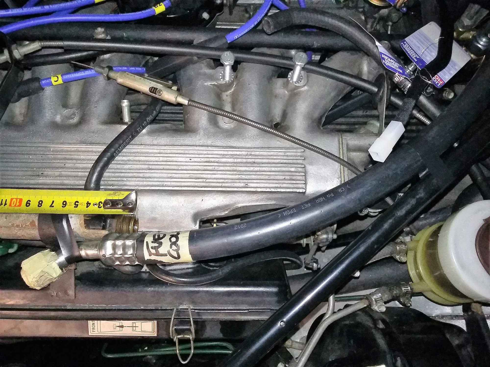

I bought this one:
FEN AIR INTERNATIONAL Ltd for Car AirCon Parts - Jaguar V12 Air Con Upgrade R134a Sanden Conversion
Yes, it is expensive, but in Czech republic it is not possible to use (and buy) R12 and I must made conversion to R134. And A/C is working w/o problems.

Nothing, the kit is complete. Only medium R134.
BUT.
If You want to order this kit, write please to Mr. Pat Foster, Fenair, that You have LHD car !!! The hose from compressor to fuel cooler MUST be other than for RHD.
#1 Hose for RHD, bad
#2 Hose for LHD, good
