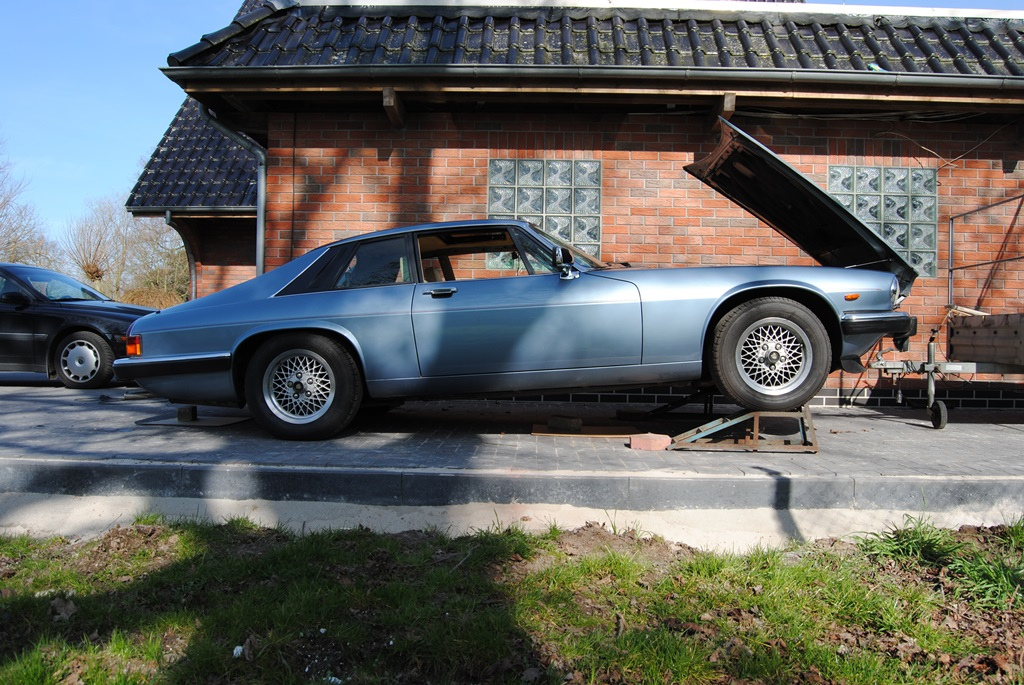

I use ramps. Due to the long nose, I use some bricks to get onto the ramps with, to reduce the risk of damaging the front spoiler lip.
Like this:
Attached Thumbnails Spending time under the car...how??-13036287665_19c1efed47_b.jpg
