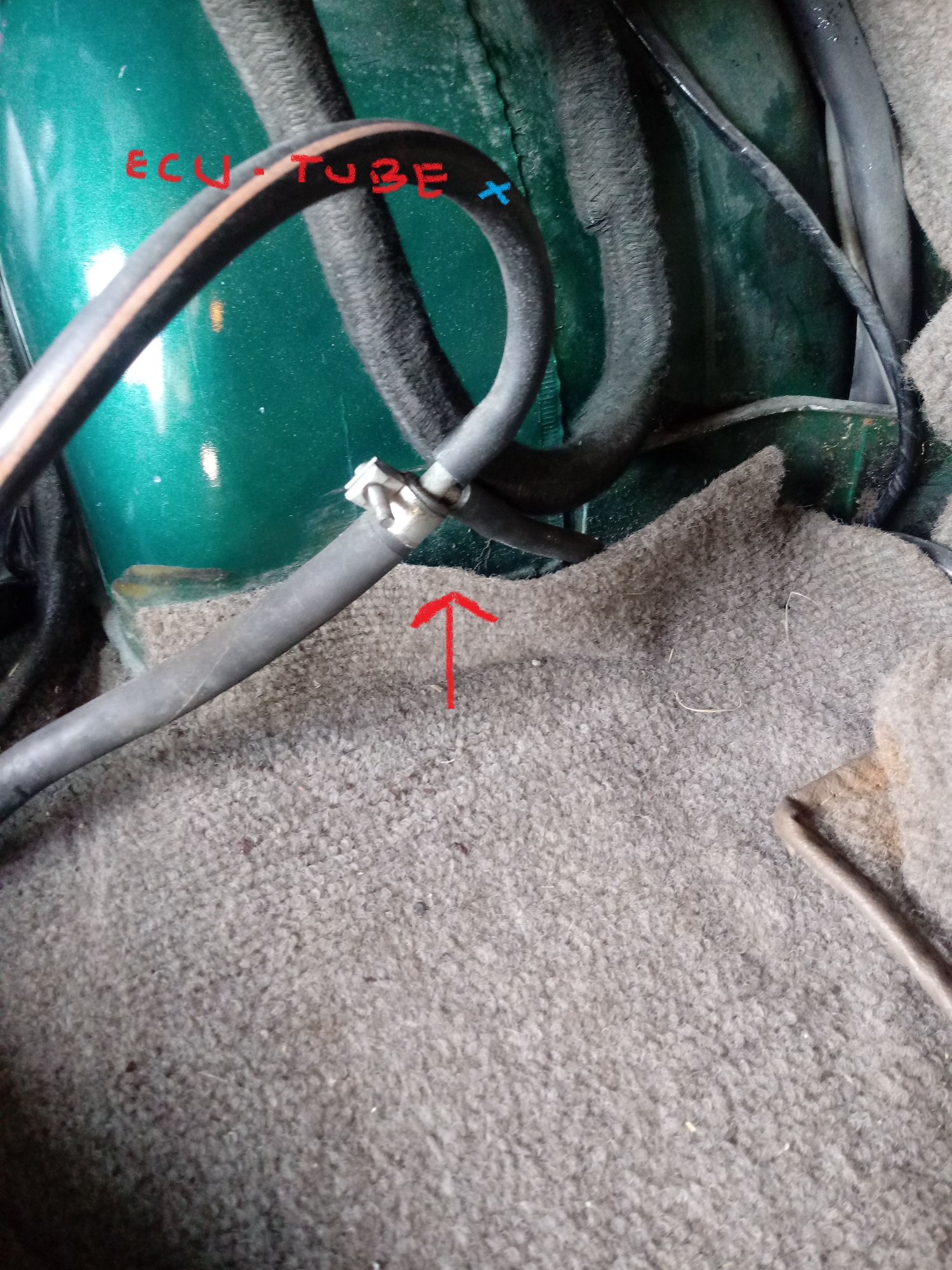

I was told by McMillan Jaguar in Motherwell to check the vacuum hose at the ECU, there is no vacuum and it is split by a T-Piece (see pic)
When I blow down the pipe there is no back pressure, due to the T-Piece I am thinking. (Explained in Bradscat post by Greg In France)

Block off the T arm that does NOT go to the ECU, and then test for vacuum as below.
The vac source comes from the balance bar across the back of the engine that links the two manifolds. Sucking on the ECU end will show some resistance, but you will be sucking some air through the butterflies, remember. If there is a bit of vacuum doing this, then the vac line is probably OK. If not, then this has to be investigated further, so post again.]

Coupla issues there.
The fuel priming with NEW FPR's every time, is NOT right.
You have bleed off, and that may be:
Injectors
Cold Start Injectors, IF fitted.
Duff FPR's, mainly the B Bank unit as it is the REAL pressure regulator, the A Bank is a damper and can be eliminated.
That Vac hose, NOT good. Replace it. The ECU will OVER fuel with a split like that, because the ECU is simple in its thought processing,
Less Vac = More Fuel, More Vac = Less Fuel. A split like taht would be very lucky to even start it.
We did not have that "T" and valve Greg so clearly explained, so I will stay out of any discussions on that.

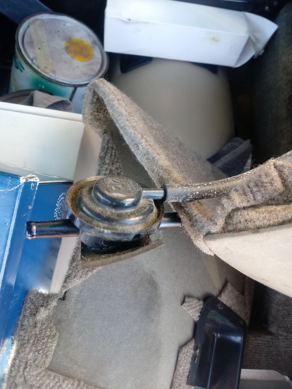

Update. I found the Rochester valve, it is attached to nothing, it was laying there attached to the hose, but then attached to thin air.
I blew down and sucked on the hose after crimping the Rochester side, air flows quite freely, not sure how much pressure there should be when blowing or sucking (cough cough).
I have a friend that has a ramp, I will get it onto it start of next week, see where is goes to and if its split..
