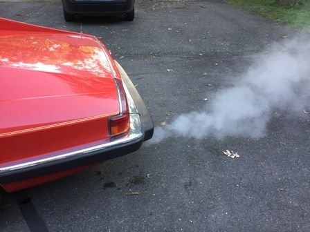

Okay, Grant, Greg and Doug have all been very helpful with my posts since I overheated last Friday. I have a terrible sense of foreboding....but I am completely open to being patted on the head and set straight.
Here's the update:
Armed with confidence, I refilled the system, went ahead and started her up (even though it burped water ALL OVER the place - the bleed hole and the center fill tube were like geysers!!) and let her idle whilst topping things off. She still burped slightly every now and then, but eventually, the reservoir tank filled, so I capped that. Then I let her keep running. There still wasn't water flowing out of the bleed hole, but vapour/steam was. I also noticed a lot of water vapour out the tailpipe. Finally, I started getting some burps & spits from the bleed hole, so I decided to seal that and move her into the driveway to idle & rinse off the wings, which were a mess.
She continued to idle fine, but the steam out the exhaust persisted, ONLY from the B bank side (see attached pic). The steam also smells foul...toasted/burned smell. Then the temperature started to climb above the center of the barrel gauge. I immediately began backing her into the garage, but she cut off halfway in. I'm now letting her cool down before I decide how I want to re-arrange the garage.
At this point, I have added 5 gallons of mixed coolant to the system (of course, a LOT has been pushed onto the floor, but I very much doubt it would total more than a gallon). I thought that was about the system capacity, isn't it? If that is the case, the system must have been virtually empty, and my assessment of whether or not I have done serious damage is in question.
Now, what say ye??
Despite the effort and mess so far, I really don't think the cooling system is fully bled. You want a solid stream coming out of the bleed hole, not a few spits.
Not sure why the engine died. Perhaps coolant splashed where it doesn't belong?
Assuming you get it started, go thru the bleeding process again. This will probably take care of the temp gauge climbing above center.
When that happens, hose down the mess (again) and take her for a spin and see what happens.
Don't be too alarmed at the steam vapor. Sometimes moisture accumulates in the mufflers and takes a long time to burn off. Why only one side? I can't say, but mine does the same from time to time. If the steam vapor from the exhaust is still there after 30 minutes of driving, give a shout.

I wouldn't be surprised if you have coolant around the sparkplugs and that shorted out the plug causing the stall. Make sure everything is dry and they try rebleeding again.
Sometimes it helps to jack up the left front side, so the bleed plug on the top of the rad is the highest point in the system and wait until you get the geyser out of that point before putting the plug in .

It is also possible that the thermostats are somehow jammed or not functioning. I would change them before trying again.

This really sounds like a blown head gasket to me. Does the oil look milky? Not always one of the symptoms but if it is, it would confirm it.
