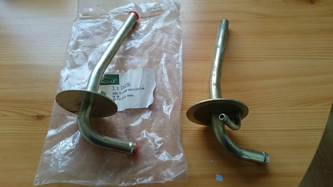

Does anyone know anything about this, why it was introduced, or if it's necessary?
Parts can be seen on the Jaguar parts catalog here, item 21:
Fuel Sump Tank - Parts For XJS from (V)139052 to (V)179736 | Jaguar Classic Parts UK
My car has this fitted, however I twisted the small pipe slightly when removing it form the sump tank so ordered what I thought was the replacement, but it doesn't have the vent tube option (I ordered part 15 instead of 22)
I think I get the theory, keep the sump tank purged of air, but in practice is it necessary? Or is it just emissions related?

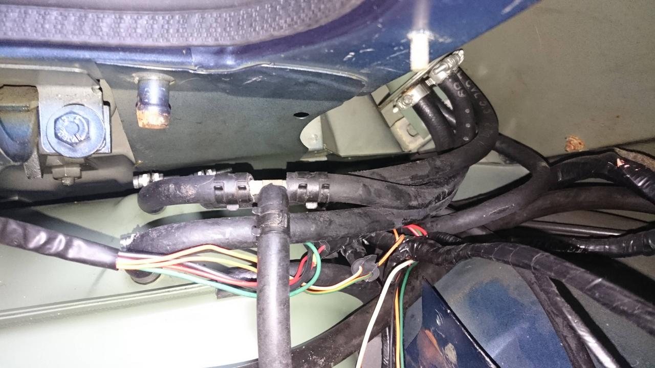

Fuel line 25 Tees into one of the 3 vent pipes in the top corner of the tank, between the tank & the small canister. Luckily I took lots of photos during disassembling everything in case I forgot something!:
I didn't realise pipe 11 was a vent, looks like pipe 25 doesn't do much then. Seems strange that Jaguar went to the trouble of adding it.
Greg, do all 3 of those vent pipes just open out into the top of the tank? I wasn't sure if one of them was a 'drain back' or not which ran internally to the bottom of the tank (and thus if I inadvertently chose it for a vent & blocked off the other two, I would just vent liquid fuel), so was going to tee them all together as a single high point & vent from that to be on the safe side.

Yes, all three pipes from the cannister just go into the tank, I suggest blocking off the lower two.
AFAICS there should be no problem at all just blocking off the pipe 25 exit from the sump tank and forgetting about it. Also AFAICS, that no 25 vent pipe up to the canister from the sump would be full of fuel to the same level as the fuel level in the main tank, quite a good plan to get rid of it! To be 100% sure all will be OK, detach pipe 11 from the sump tank and blow though it just to check it is not blocked inside the tank.
Greg

Its to make hot start problems less of a problem. I have some of the vented ones in stock which are no longer available from jag. If you do away with yours make sure you sort the T piece pipe out.
