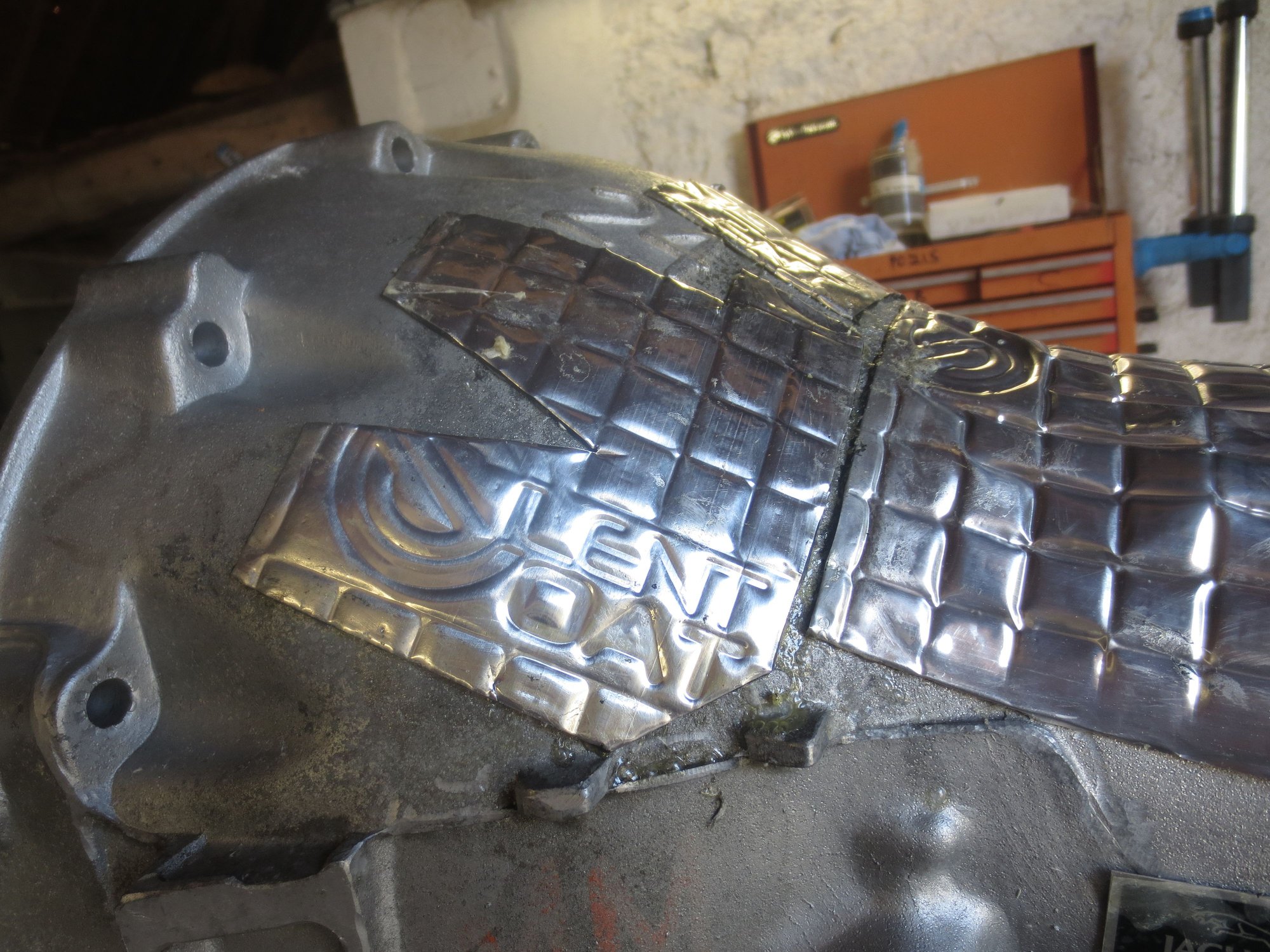

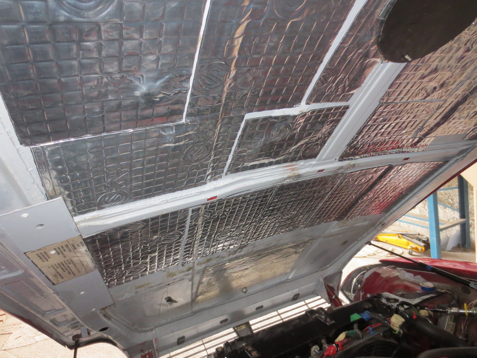

Ben this stuff is good and cheap, I have it on my bonnet and gearbox:
https://www.silentcoat.co.uk/collections/silent-coat
Comes in various pack sizes:
https://www.silentcoat.co.uk/collect...-deadening-mat
The glue on it is fearsomely strong too.
only 2mm thick, far better airflow

I'd prefer not to use the stick on stuff - at least not that uber grip stuff - many of the offerings out there are that very same structure since they can't function unless 100% in contact - they don't stop sound they stop vibration of the substrate - I believe Jaguars original inner wing stuff was glued, the bonnet stuff wasn't. I'm not convinced that restricting airfflow on the bonnet is a good idea - water will get in there and you won't see what it is doing.
Whilst I'd like to keep things quiet as they were from the factory I'm not hell bent on doing so, heat management is my primary goal.
