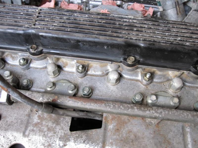

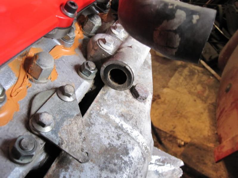

OK, I have just spent a little time in the garage on this rainy/sleeting afternoon. Update:
The bolt on the A bank camfeed is 5/8ths. As Grant said, if the vacuum-controlled water valve is removed, AND the oil pedestal, and any bits of loom, water pipes in the area, and the cross-pipe that balances between the two manifolds, and the throttle pedestal, I am sure you can get a ring spanner with a slightly angled head onto the A bank camfeed banjo bolt; going in from the V horizontally.
Best to tie a bit of strong cotton thread to the spanner and to the car! Spanner might need to be bent a touch if necessary, as required. Have telescopic magnet ready to catch the bolt.
B bank has enough room as the offset on the crank means it has a couple of inches clearance.
As Grant said (genuflects towards the Southern Cross) getting the A bank banjo bolt and washers etc back in is going to be very hard. There is 1 inch between the bolt head and the fibreboard tunnel heat shield, which is just infront of the actual steel bulkhead. If you have to, the fibreboard heatshield can be vandalised to give about 1/2 to 3/4 inch more clearance. This can be done with a long chisel or screwdriver, not pretty, but only you will ever know!
As you will be fitting a new pedestal and new oilfeed pipes, this might make reinstallation just a touch easier. For instance:

Greg,
By the look of that picture, you have some glue around camshaft housing. Was it seeping oil from there?
I suspect that I have seepage there as well, because I see some oil smoke come out when engine warms up. Were you able to apply glue with engine in the car, or was it on the outside? Lastly, what kind of glue?
Greg,
Oil seeps out of the join between the tappet block (carrying the cam) and the actual head. This was apparently a metal to metal join at the time of construction. Understandable, for it is crucial to valve clearances. Here is a 'before' photo of that join from the side on the cleaned up engine prior to cam cover work:
Here is an 'after pic:
My friend Martin, who is a real Jaguar expert, and great bloke all round, and runs his own Jaguar garage business which is so successful he never advertises, told me that most of the oil that escapes onto the exhaust manifolds comes from this join, and that sealing it as shown works wonders. Not, I hasten to add, that he would advocate this as a fix, except for tyros like me who are too chicken to remove the tappet block and apply a modern Loctite-type hi-tech sealer to the metal faces.
So I ordered up some very high spec silicone that withstands 400°C no bother at all at vast cost for a standard tube, from these people: High Temperature Sealant, Chemical Oil Resistant RTV, Heat Proof over 300C sealant
Then I took some sandpaper and went all round the head/tappet block join roughing up the alumin(i)um each side of the join. Then as you see, I liberally applied the bodge and pressed it home with a finger to get it to key. (Madame does mention for time to time that aesthetics are not my strong suit). The stuff goes right round this join including the side in the V.
That was 18 months ago and I have done quite a few hot weather miles since then, including a couple of 250 mile very hot trips, and it is still holding and seems to work really well. Of course, the oil seeping out is not under pressure, just finding its way home to the sump.
Greg
Hey Guys,
Here is where I stand with this project. (By the way, I have not given up nor am I discouraged as I have a plan!)
Thankfully, one of the posters on this thread had a spare of the part that was broken. He shipped it right away and I have it in hand. I cannot thank him enough for that. So, I have all the parts I need. That is the good news.
When reading your various responses, it became clear what were not viable options. Removing the engine -- too costly for this car. Trying to raise the engine and move it a few inches forward -- I would mess something up worse than I already have. Remove and replace passenger side cam banjo bolt -- if I stripped it, I am back to the non-viable remove engine option.
So, my plan is to carefully cut (with a tubing cutter to avoid metal shavings) the old metal lines while still in place, cut the new metal lines attached to the new pedestal and banjo bolt assembly, and then place and double clamp a high pressure hydraulic hose to fill the gap between the old and the new.
No engine removal, no stripping of existing cam banjo bolts, but a completely functional and permannent solution. Pictures forthcoming after the operation next week
Thoughts?

Give it a go, say I. If you can find one the right size, try to solder/araldite an 'olive' (brass compression sealing ring) 8 mm down the pipe each side. Also rough up the pipe a bit with coarse emery paper so the flexible has something to grip onto.The danger is that the new piece of tube will get pushed off by the pressure, and a 'hump' on the tube that the flexible can be pushed over and the clamps fixed the other side of it, will greatly aid the flexible's grip on the pipe each side. Two clamps each side is a very sensible idea too.
Also, ensure you get a piece of flexible that can withstand heat, certainly got to be good for 150°C, I would have thought.
Great news that you are up for the whole thing, good for you and good luck
