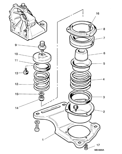

There is no cushion. The spring goes into the spring cup and into the upper spring seat. Its a 6 cyl trans. Does anyone have a picture of the mount?

Here is the 6 cyl trans mount.
Please put your car details in your signature. That saves a lot of gues work.
The 6 cyl trans mount is "kinda loosey goosey", as Doug has stated a few times over the years.
I am not aware of any specific fluid leak areas on that ZF trans.
The guys on the XJ40 and the X300 section might know more, as that is the standard driveline in those 2 models.

My mount only has item 1,2,4,9,10. It doesn't have those other parts.

Looking at that picture, that lower spring and all its associated bits are contained in teh cup assembly as part of #1. So, #2 to #8 are all bolted together with #18 bolts X 3.
The rest of it is outside that arm/cup assembly. Quite complicated and inticate in my opinion.
Hopefully someone here has an answer, or the guys on the XJ40 might know more.

I don't have all those parts. My spring goes into the lower cup and then into the upper cup. No parts bolted together.
