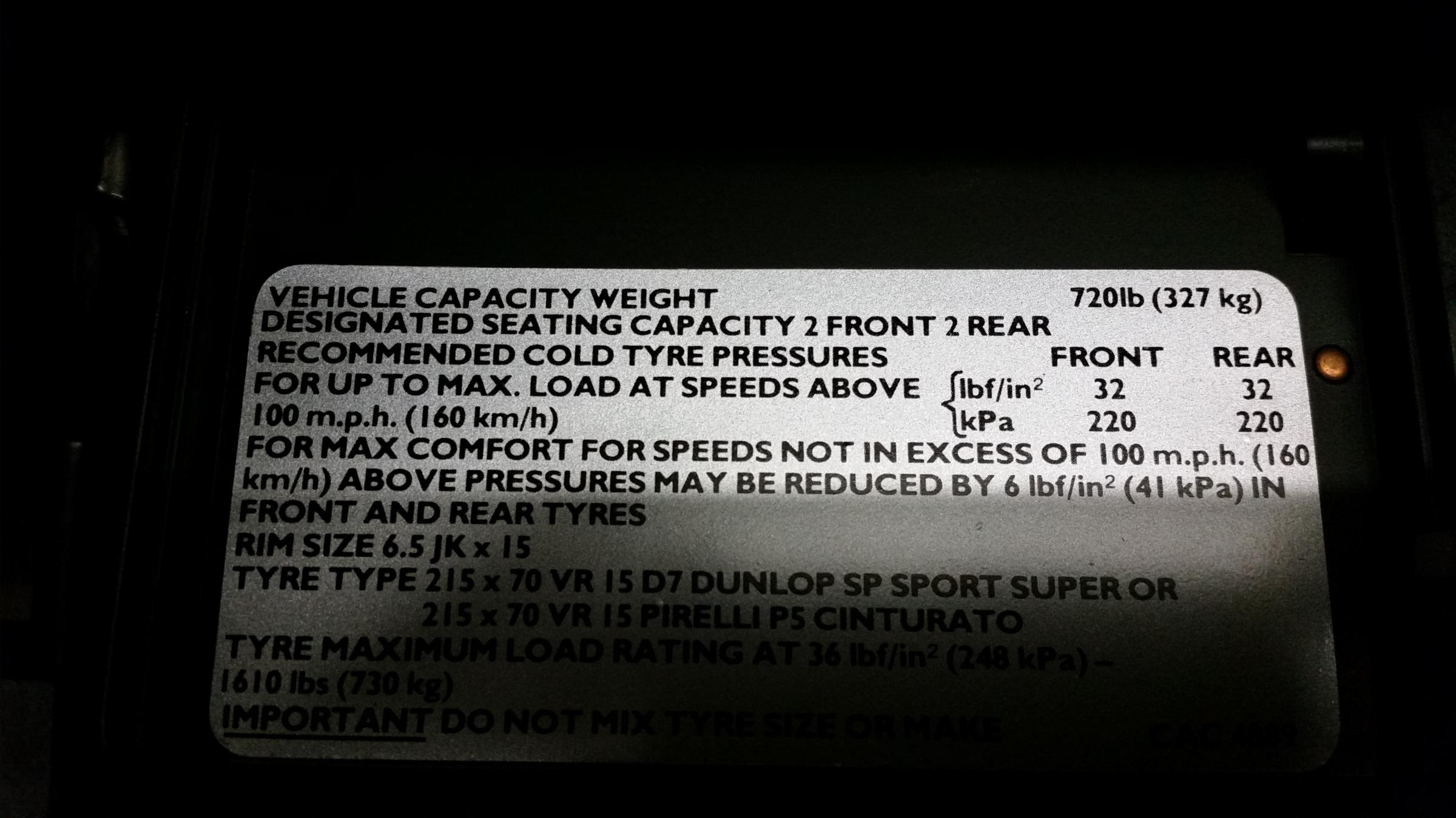

I was tinkering in the glove compartment and found a little sticker that says "Mirror" with an arrow pointing to it. I hadnt noticed it before
So when you flip up the mirror it has the sticker for the wheel pressures and all.
And this is what it says, but note it is for 215/70's.
