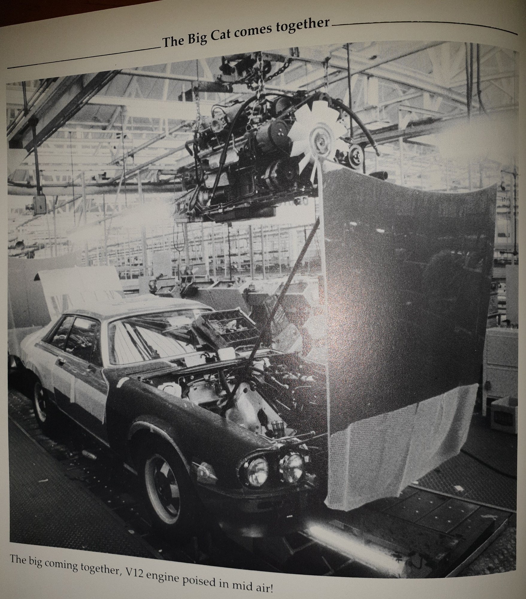

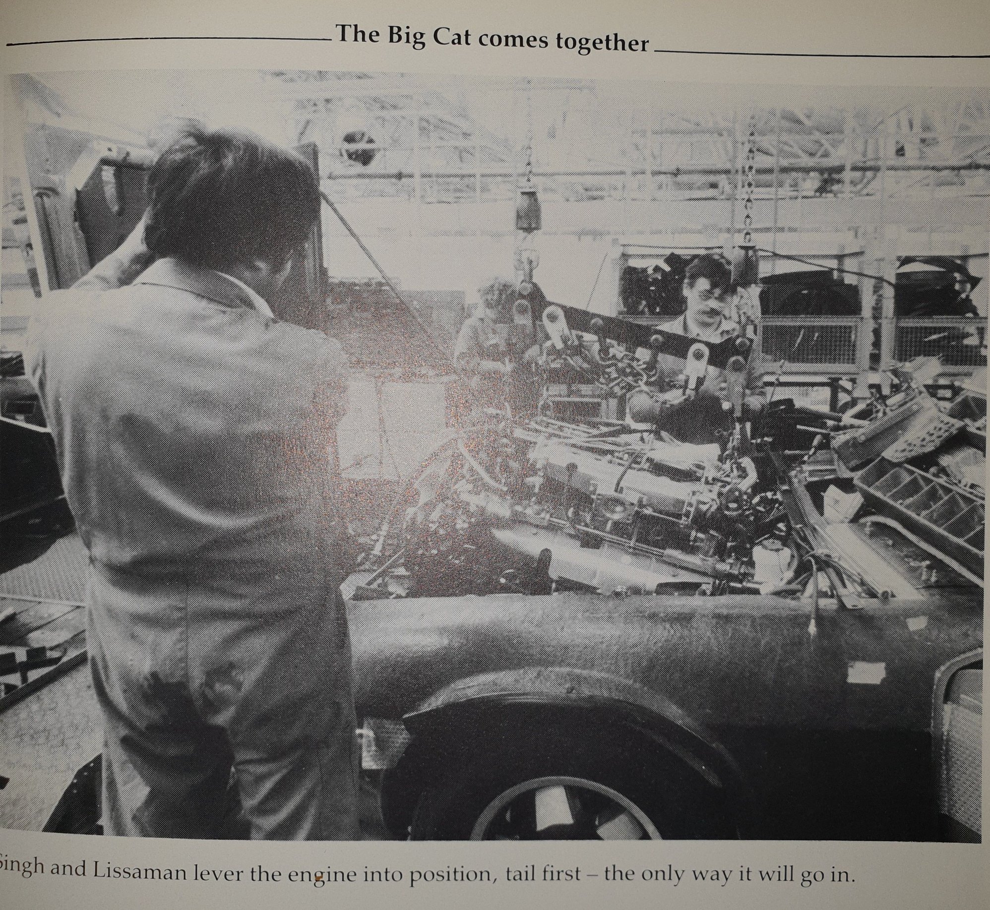

Amazing what can be achieved with the right set up.
Factory even had bonnet fitted before engine/trans.
