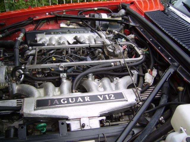

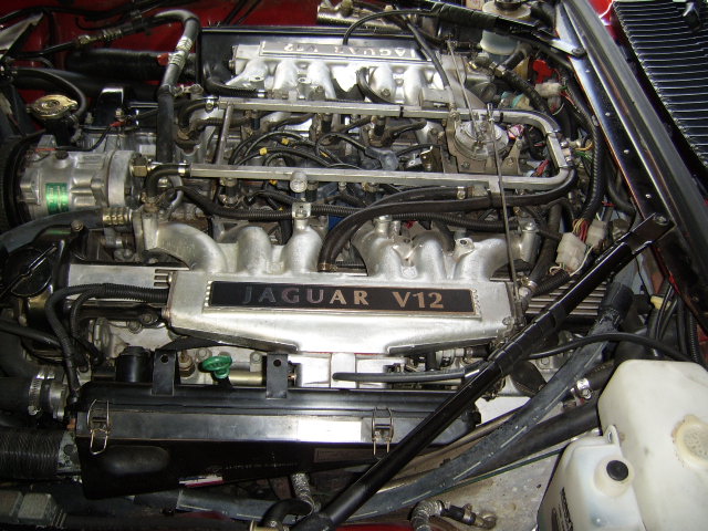

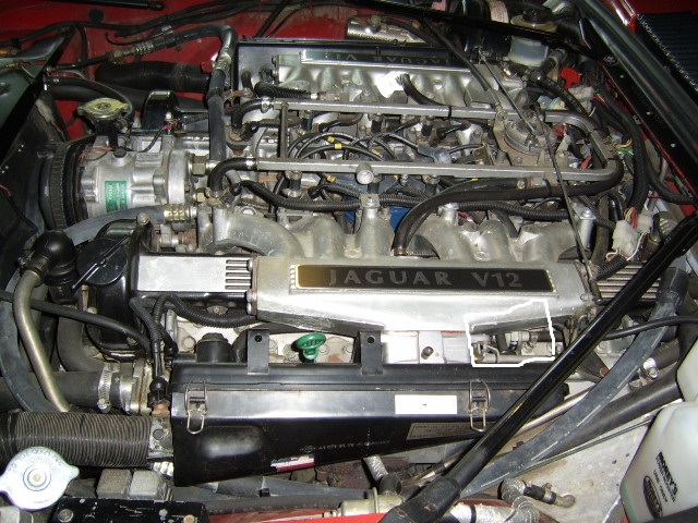

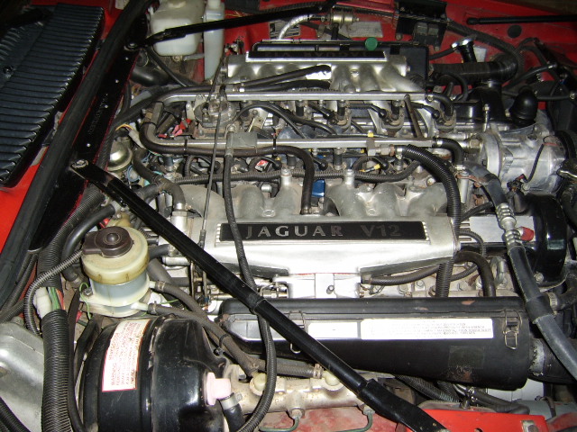

Mine is Pre Marelli, so different in that there is only one coil ead.
I have 90deg on 1A 1B 6A 6B 5B, and that makes them "flow" a tad neater. They are ALL 90deg at the cap, including the coil lead.
I use Magnecor ONLY, and they are pre made length, with tags, and BLACK.
These snaps show my set up, but NOT those leads specifically.
