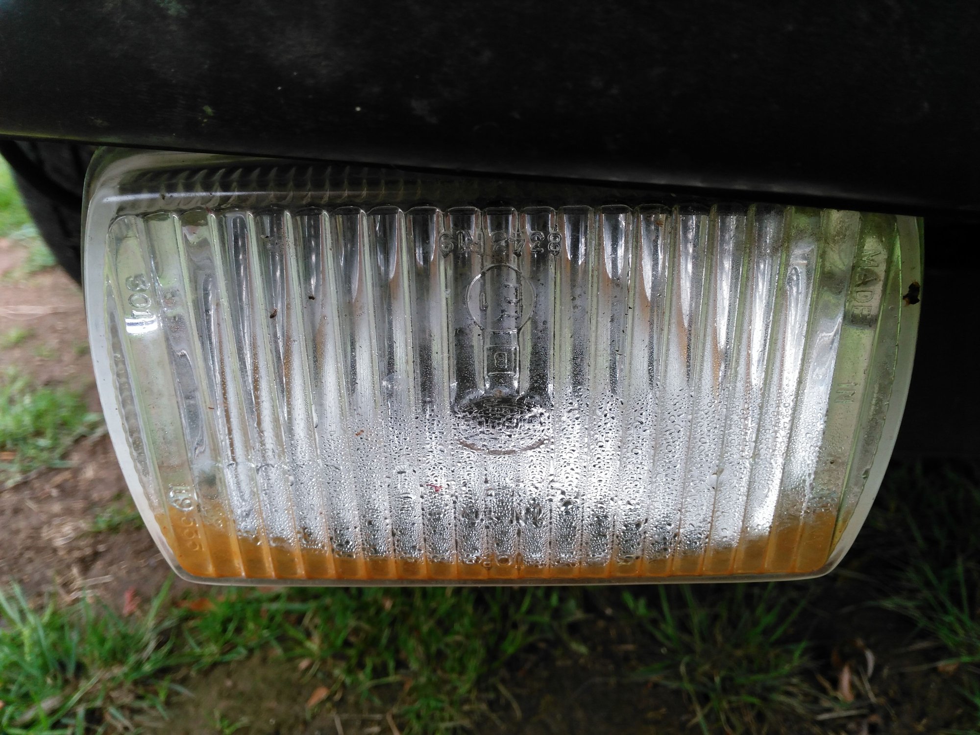

Hi Guys
Got a problem which I never noticed before
It looks like I've got Water in the Fog Lights, which is very unusual as I never take the Car out in the Rain and so it must have happened when She broke down last year in the middle of nowhere, where I had to sleep in the Car for a couple of nights
So How do I get the Lenses off to drain the Water out before the reflectors go rusty?

Take them off the car, take them apart. clean everything, including the contacts and get new seals for the glass to case assembly. Fully dry, add new bulbs, and reassemble.

If they are the original Hella lights, there are 2 plastic screw fittings on the back chrome body. Light then disassembles.
Good luck
Paul

Hi OB,
And when you put them back turn them 180 degrees - notice the "TOP" marking on the bottom of the lense in the photo. Maybe there is a drain hole if they are not upside down.
Thanks,
Jukka

Hi Paul & Jukka
Do you mean just turn the Lens upside down and then put the Lens back on, or am I missing something?

Exactly. As far as I recall there is a small gap in the gasket around the lens on the bottom side which will allow water out. Did you pass MOT with the lens upside down?

Water also comes from condensation in the lens..
