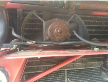

can someone please identify the model xjs this rad fan is from
RGP, The only market where Jaguar fitted pusher fans in front of the aircon radiator, AFAIK was Japan. This was definitely done on the X300 V12 model, but whether it was done on the Japan market XJS I do not know.
Is the installation definitely factory, do you think?
In principle, a pusher fan is a good idea for aircon performance in slow traffic, IMO. My problem when considering fitting one was it seemed impossible to find a fan with (i) enough airflow, (ii) a small enough hub not to restrict normal airflow, and (iii) one that be both and would fit in the space.
Greg

Looks like the aux fan from a Ser III XJ6.
Have a peek at the first pic in this series:
Welcome to Jag-lovers - Members Photo Viewing Page
Maybe Jaguar used the same design on the earlier six cylinder XJSs ? I dunno
DD
Greg
the guy on eBay selling them is an xjs breaker in or near Dorking he has 4 of them listed, but doesn't answer emails, I have since found the fan on jcp web for the 3.6 xjs. why they switched on the 3.6, who knows. def. looks the same unit as the pic doug
thanks guy's for the thoughts, and have a GRAND CHRISTMAS
