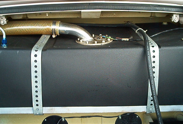

all to familier with rusty tanks, 60yrs worth of ideas.
so when restoring my 78 XJS , i just jumped ahead of the problem areas.
NO rust ever again in my car, Plastic fuel cell(22 gal), stainless steel pump and filter, anodizied fuel ines with anodizied Aeroquip fittings, fuel rails billet aluminum, and stainless steel injectors!
what the hell,may as well do it 100%.
you know money is not important when it comes to our TOYS.
