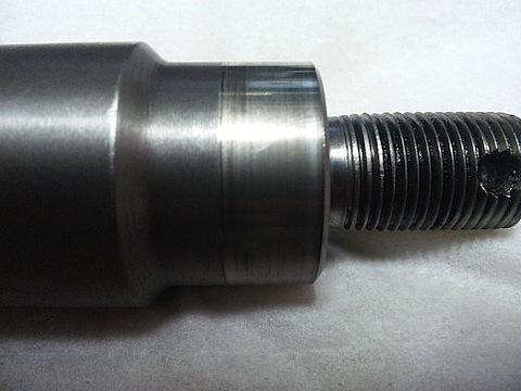

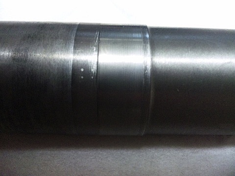

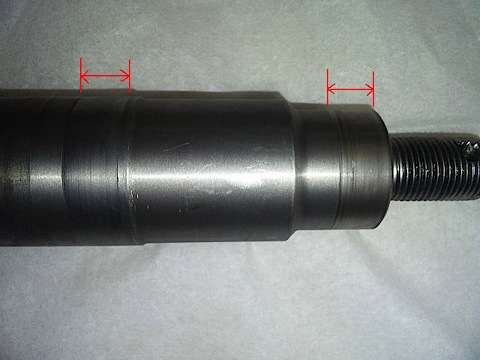

The stub axles, where the bearings sit, can wear. This could be a source of observed wheel play. Someone on this forum suggested testing for this wear by using a finger nail to feel for a step underneath.

FYI, worn stub axle pics...
Thanks for the pictures - so they will obviously be grooved or serious wear? Do they come pre-grooved at all?

No, from the factory the surface all looks the same. So the area outside of those grooves. They can still be shiny or show some wear, but like he said you can feel it and see actual grooves, not just a polished wear pattern.

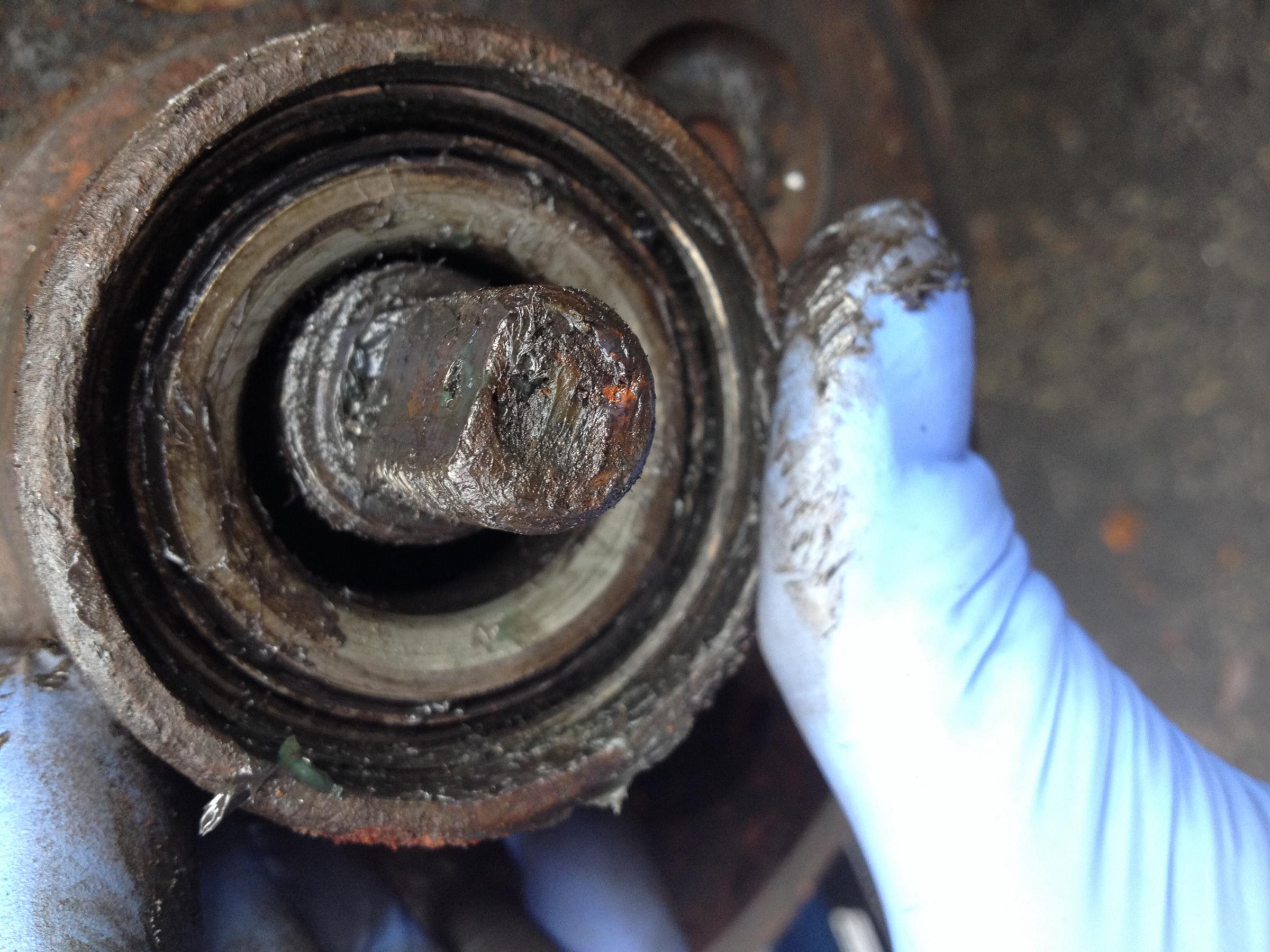

Speaking of wheel bearings. Check out the bearing I found on my 89 convertible.
Id say a tad small. But in their defence there was a piece of coke can rolled over spindle to take up the slack.
Some people shouldn't work on cars
OMG that is crazy. And dangerous......
