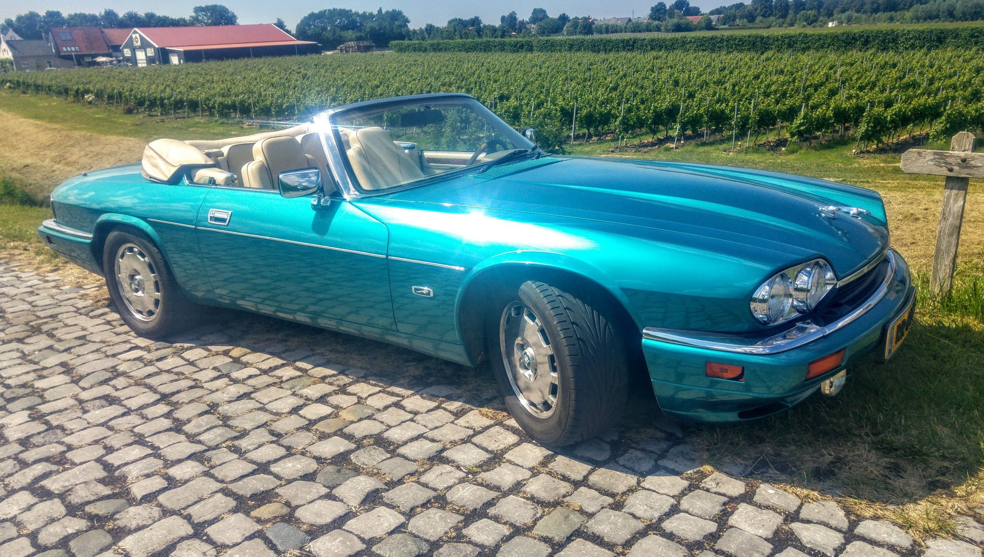

I only got wider on the standard 16 "7J rims. Tire size is 245/55/16

That's why I chose the same rim diameter and tire height, just a bit wider. Drives great.
