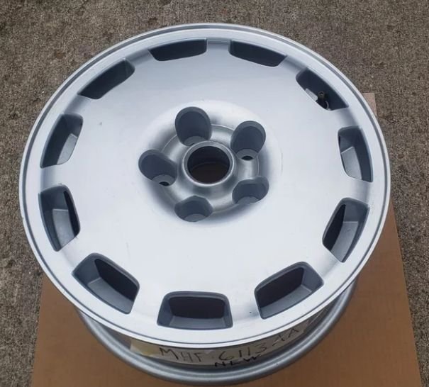

I really like the late late XJS ‘phone dial’ wheel - it’s a 16x7 28 offset.
Can’t find them. If you have them for sale, please DM me!
So, there are several wheels that are for other sedans that I like too. Those wheels are 16x7 33 offset.
My thoughts are a 5mm spacer plus longer lug bolts. Am I thinking right?

Attached is a picture of what I’m looking for.

I've learned that these are called 'celebration' wheels.

Scott,
Those are the wheels which, in standard format, were the default wheel for the 4 litre cars from VIM 221855. That particular wheel has been refurb'd and powder coated / painted. An original one should be diamond-cut on the face.
Jaguar usually refer to them as the "11-Spoke Alloy". Some people call them "Aerosport" wheels. I THINK that US customers MAY have had an option for them to be chromed. I've never seen a chromed one in the UK. The other option wheel on the late XJSs was a chromed version of the 5-spoke.

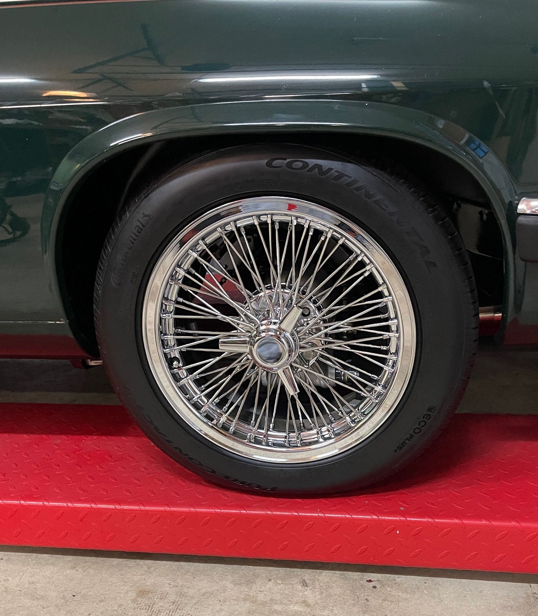

Don't know if the Dayton wire wheels that some US owners bought, were always an after market addition? I think so?

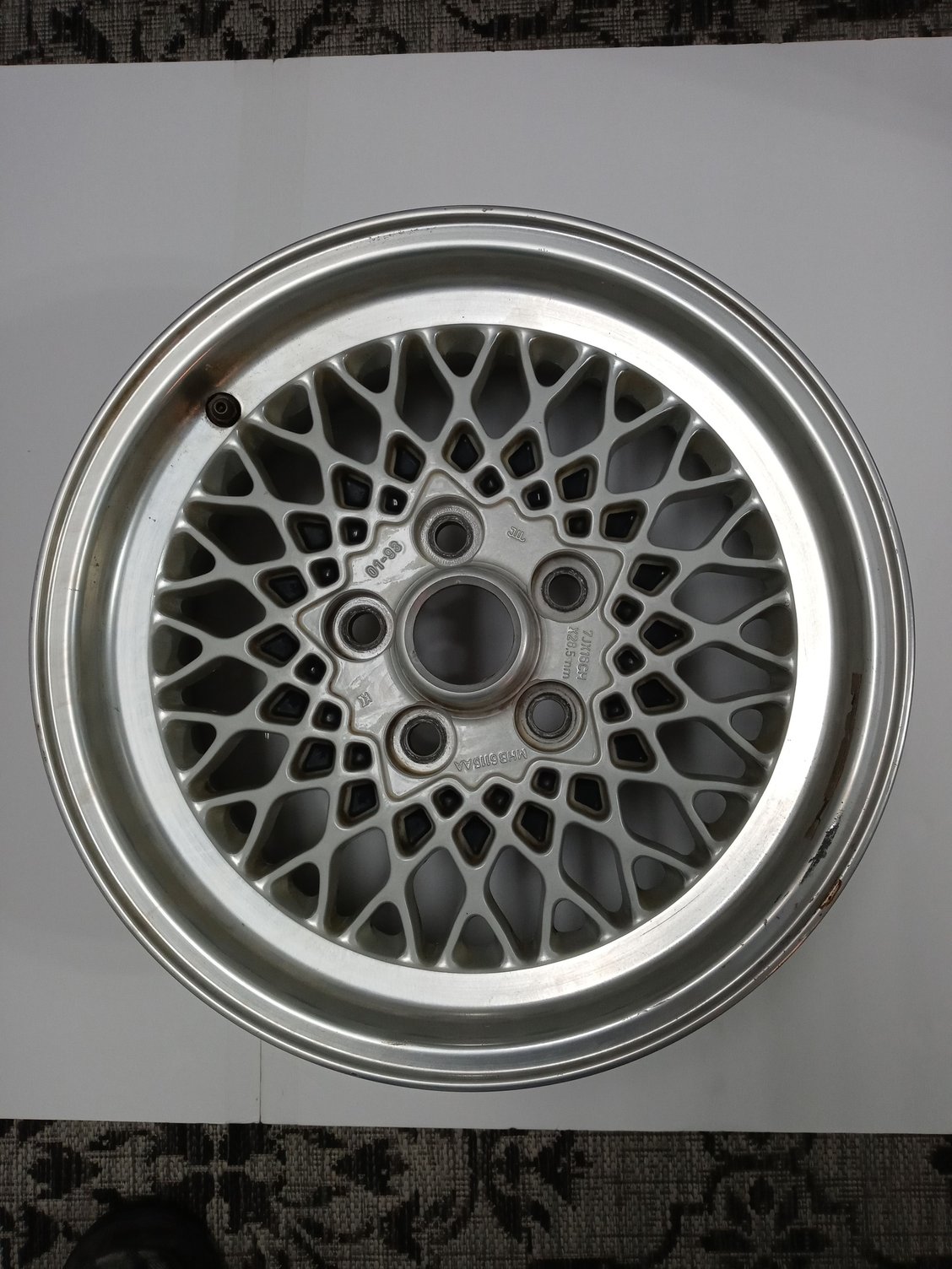

The rare 7j x 16 lattice wheel.
Wow! Serious BBS vibes with that one. Love it

I have 9 of them.

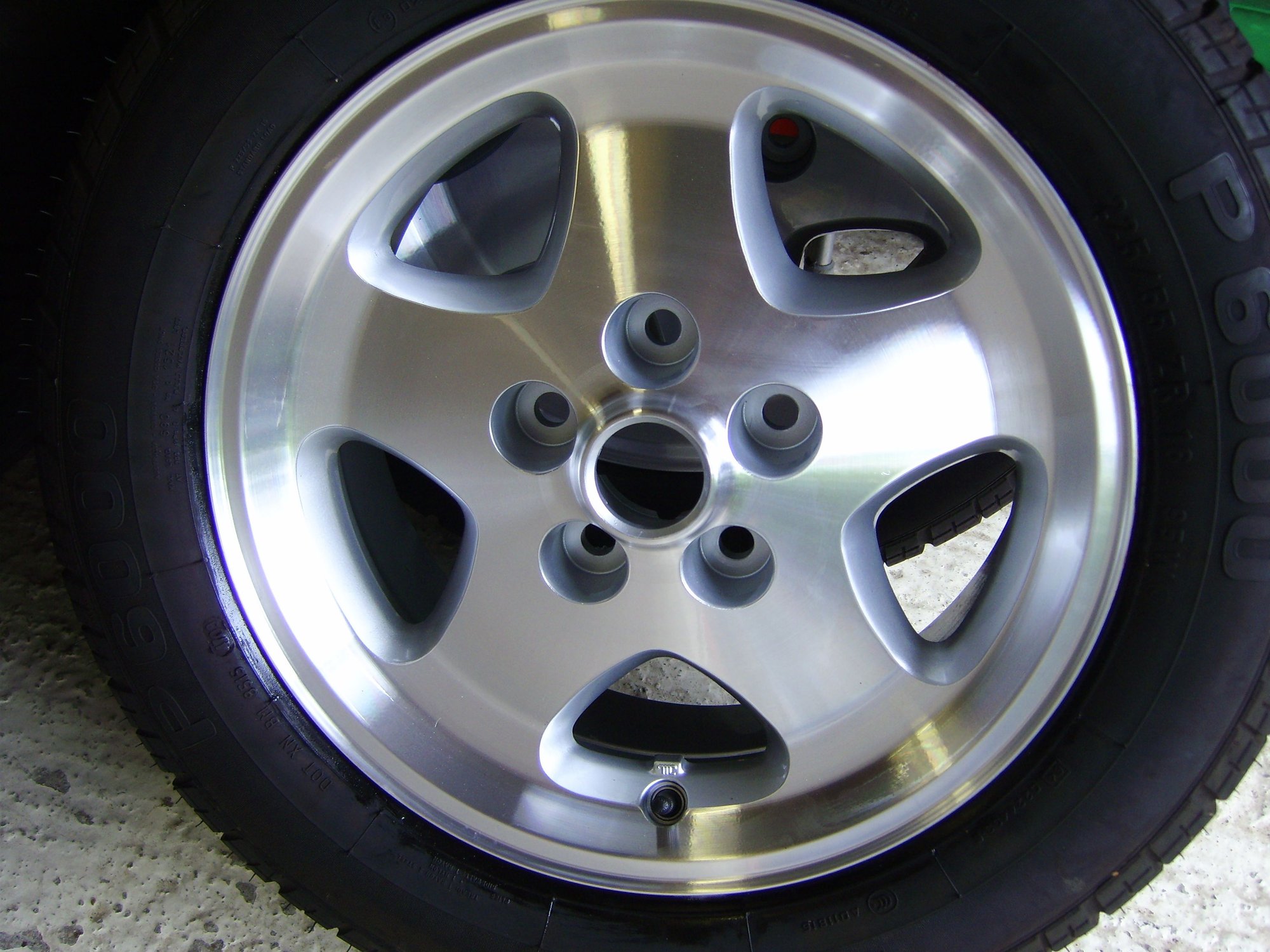

Most of the variants of 16" wheels had very short periods of standard fitment as Jaguar changed the spec of the XJS quite frequently from 1991 - 1996. So most were fitted for only 12-15 months before being changed.
My 1994 AJ16 4 litre Convertible has the 5-spoke no-groove diamond-cut wheel that was only fitted for 11 months from May 1994 - April 1995.
