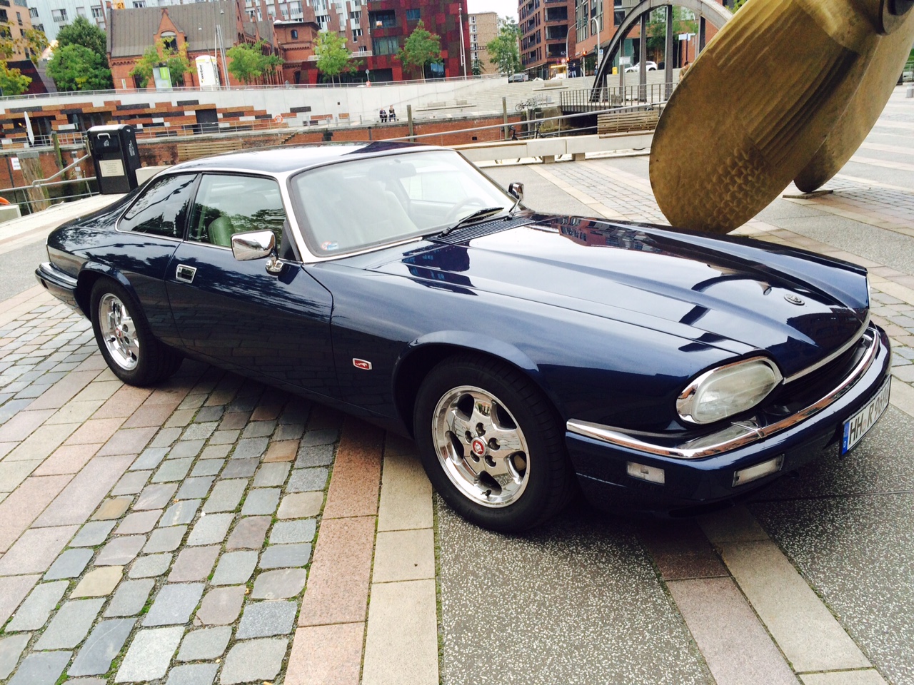

What do you guys think about these white indicators? I´m quite happy with the "fresher" looks of my car.

Those look great, I like them. You're right, it definitely freshens up the look of the front a bit. Did you make them yourself, or purchase them somewhere?

White markers are probably available for any vehicle on earth, except one: The XJS:
So I had to cut the markers open with an electric-saw, organized me a mold maker to craft white copies of the transparent parts and glued the result back together with the marker-basis.
S**t-load of work, but worth it (in my opinion)
Regards
Hendrik

If you want to do it right, there isn't always an easy way to do it. Nice work, I wondered if you had molds made for it.
So, theoretically, if you have a mold, more parts could be made from it in the future for other XJS owners? If I had a facelift I would be jumping all over this!

Well, this is not a commercial project for me. But there are indeed molds existing. So there is the possibility to produce some more sets.
But its not a "plug and play"-solution. You have to cut the original parts open with a tool like this: PROXXON - MIC
and glue everything back together with black flexible glue. As well you have to paint the bulps orange. I could deliver just the transparent part, everything else is diy. And its not really cheap. And its just for the full facelift version.
If anyone is still interested, please send me a PM asap. The mold maker is actually producing a spare set for me, so I would just order some more.
