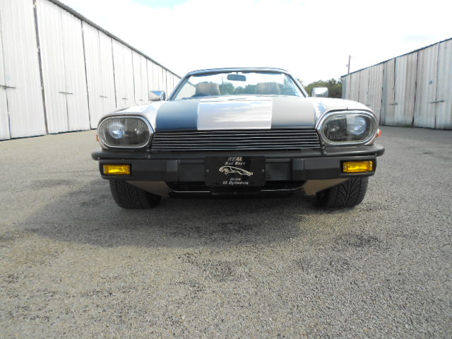

it'll be interesting to know the final weight after all is done, ready to race!
my XJS rodster, is an actual scaled weight of 3360lbs,1/2 tank fuel, no driver.
drives much more responsive than the 4100lb factory car, like brakes, quick turnin, acceleration, more nimble.
being an open car tho it is somewhat flexible, but it aint no race car, just a fun to drive hi-way cruiser, garage queen,and show car.
