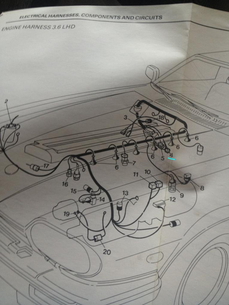

Sorry man, realized after I took the pics that there was a possibility you aren't from the US. I just assumed and took LHD pics
Attached Thumbnails Xjs-photo27.jpg   Xjs-photo28.jpg   Xjs-photo29.jpg   Xjs-photo30.jpg

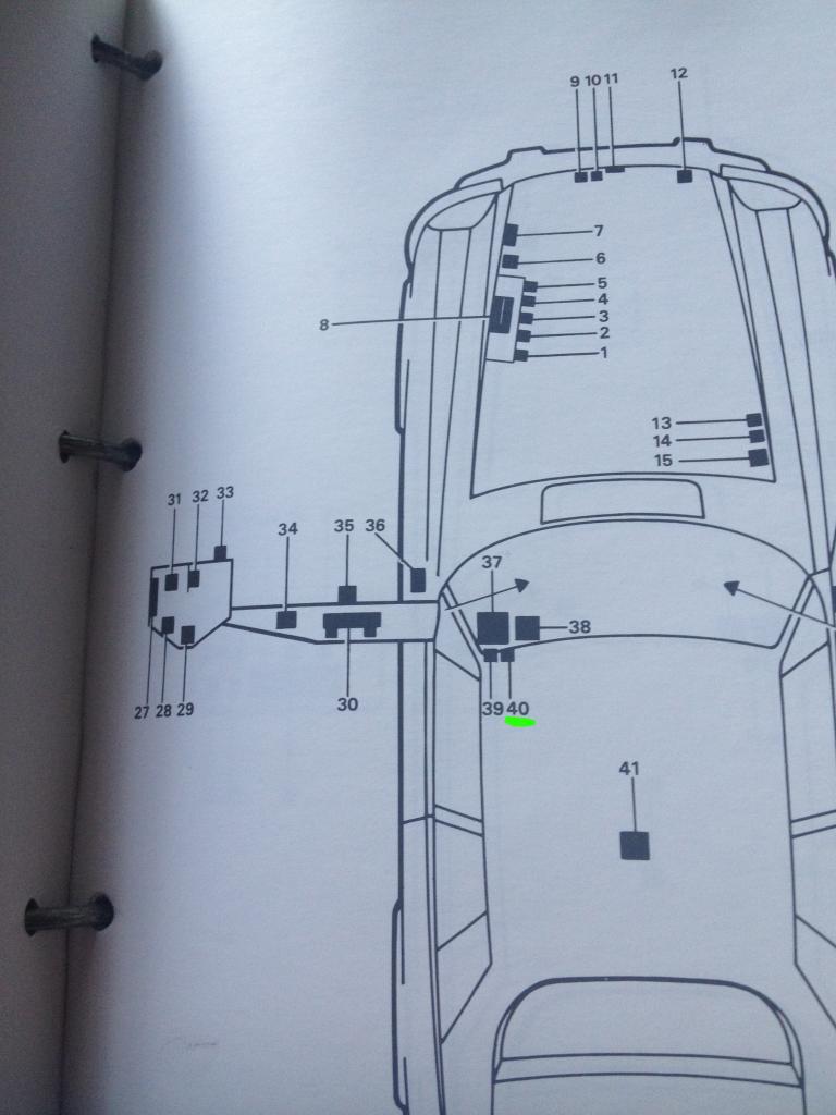

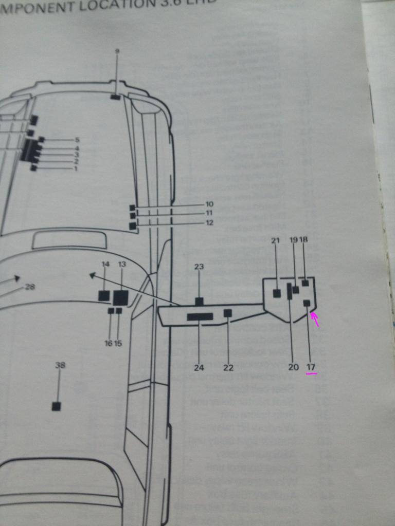

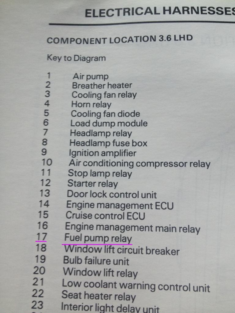

here

Top stuff SS,
John, just drop the under dash panel on the passenger side, (three or four self tappers) and you will see it.
