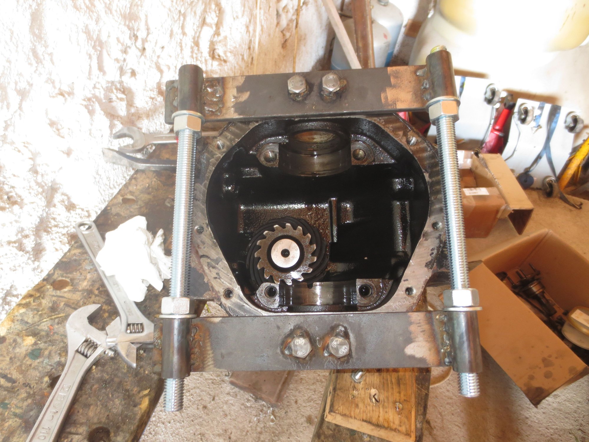

And now another one from me - senior moment edition:
I am in the process of deciding how to rebuild my DANA differential. Stage 1 is to remove the LSD unit from the casing. Following U tube advice I built myself a stretcher, as in my case the unit (which is an interference fit) could not be levered out. Photo herewith of the casing and stretcher after I had removed the lSD unit. (There are two 1/2 inch diameter unthreaded holes in the casing each side which the two short bolts on each bit of bar go into, to pull the centre of the casing apart a few thou:
Notice the bits of tube welded onto the bar, so the nuts can push the two bits of bar apart? Well I was just congratulating myself on a nice welding job when I noticed that on the second piece of bar, I had welded the last bit of tube on the wrong side!

greg you bad boy!!!!lol.
