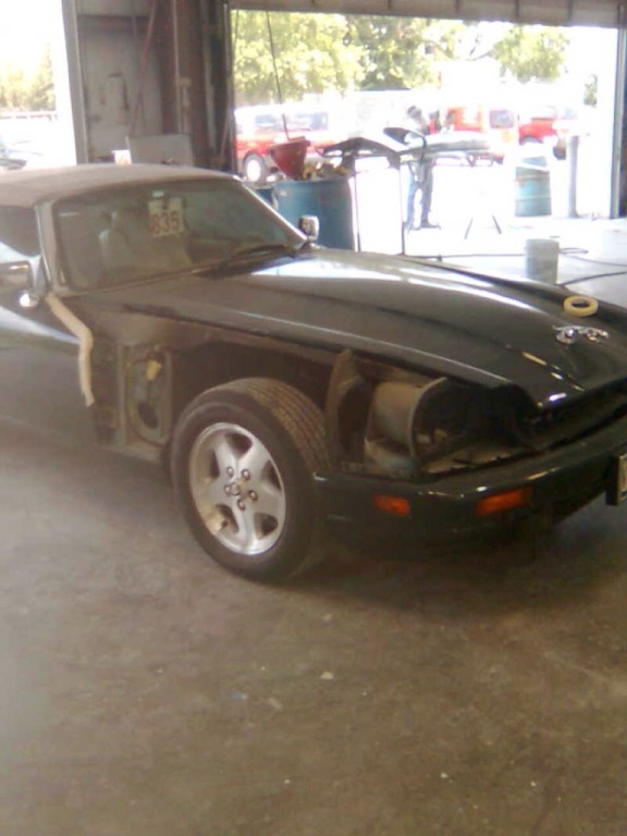

Hello, these pictures where taken after my doors, fenders, trunk and hood came of for a strip to metal/repaint . On these pictures everything was already back in place except for the fenders. As far as I know it's only those top bolts::

There are two screws at the bottom of the inside fender and two or three along the vertical flange that bolts to the A pillar that you've missed.
You'll have to remove the rear splash shield from the wheel well to get to all five mentioned above.
