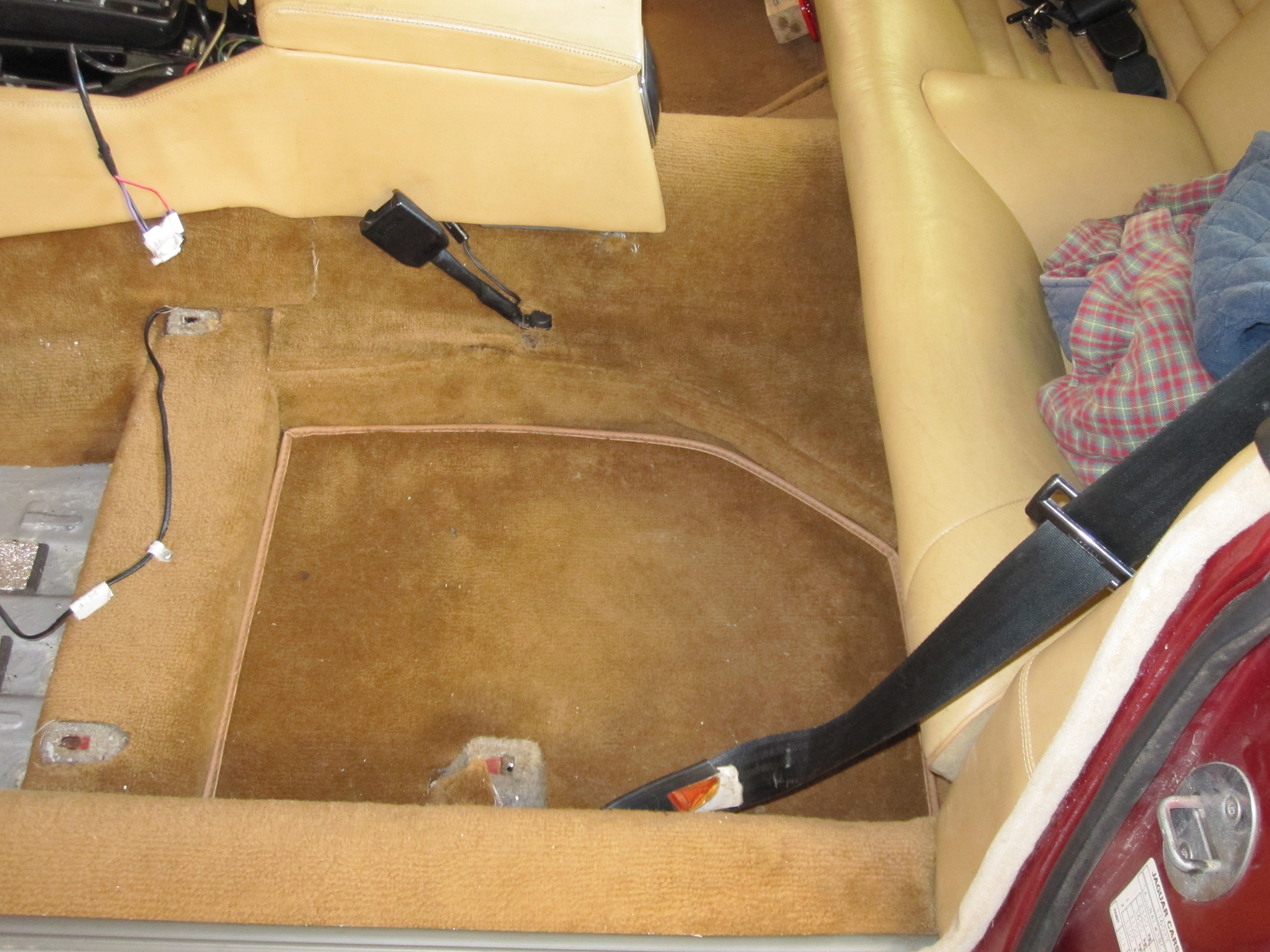

It is not the seats or the runners that are the problem, but the floorpan towers they fix to. The towers on your floor will be too close together for the older seats to bolt to. Changing the runners will not help solve that difficulty.
The outer floorpan towers (the two nearest the door side of the floor, front and back) will have to be cut, and welded in a changed position to accept the older seats. The runners just bolt to the towers. It is quite important to weld properly, rather than use (for instance) an adjusting bracket and a couple of bolts, as seat fixings are safety critical in a shunt.
In the pic below, you can see all four fixing points, and it is the bottom two in the photo that you need to refix further outboard to get the older seats to fit. The fore and aft dimensions are the same, and the back seats and door cards, rear armrests, tunnel console are the same, except that the rear seat cushion may not have a central cutout for the rear seatbelt buckle, if rear belts are fitted to your car.
Greg
