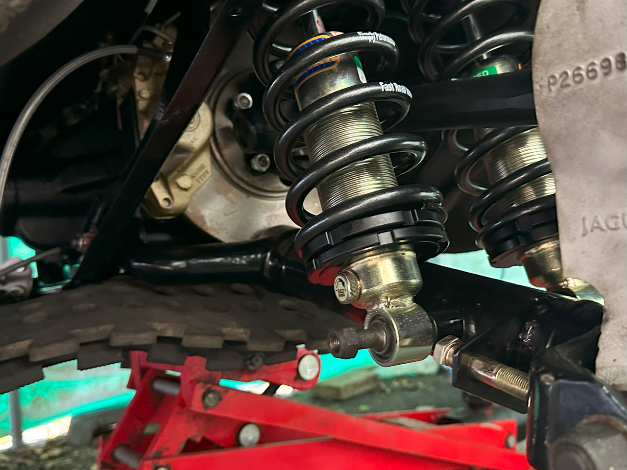

In support Doug I will add that if you are going to replace rear springs then replacement of the front should be done too to help deal with ride height issues. It isn't so much the spring length as its rate as in how much it compresses for a given weight vs length. I'm not sure if anyone actually knows the appropriate rates with any certainty given the suspension geometry in use though I'm sure with enough commitment it could be calculated. Even if it were calculated finding something with the appropriate free length, inner and outer diameter, and coil dimensions would be no fun at all. I don't even think measuring the 'wire' thickness helps because behaviour will change with material and the number of active coils.
The last thing you want is a different behaviour front to rear, that's a recipe for finding the ditch or worse.
My advice to anyone is to change all 6 springs or non at all unless a broken one gives you no choice.
Me I put Eibach 'Fast Road' from Simply Performance all round - and that might have been a mistake those suckers are stiff !! - I'll provide feedback once I get the thing mobile again. (I cheated on the rears because they came with adjustable Spax dampers and were assembled for me)
I found this and thought it may help expose the pitfalls with selecting springs - and how fast it gets complicated and this doesn't even cover what will actually fit the car ...

The Eibachs ruin the beauty of the car! Standard sprins and decent shocks work wonderfully on the XJS. Berkshire Jaguar have good fronts, made in the UK too. Rears, in my experience, you are far better off using OEM ones, however old. There are loads of second hand ones about.

My old springs (front) were toast I do have a full set of 'Monroe' rears hiding in the garage - they just aren't very pretty when you have buried 1000's into the subframe ...
