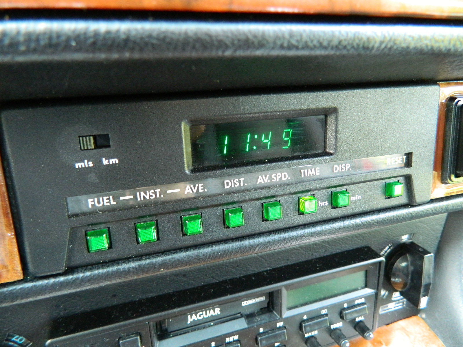

I am new to my XJS but I am not sure I even understand what the numbers are telling me on the trip computer. They don't seem realistic for anything. Anyone have a short description of what I am looking at when I push each button>
RESET: Hold this switch for 10 seconds to reset the computer.
RESET-then-DISP: Hold these switches to set the minutes on the clock.
RESET-then-TIME: Hold these switches to set the hours on the clock.
DISP (DISPLAY): Press this switch to blank out the display while the computer is on.
TIME: Press this switch to see the total time on since last reset; it then switches to showing the time of day.
AV.SPD. (AVERAGE SPEED): Press this switch to display the average speed (in the current units) since the computer was last reset.
DIST. (DISTANCE): Press this switch to display total distance traveled (in the current units) since the last reset.
AVE. (AVERAGE): Press this switch to display the average mileage (in the current units) since the last reset.
INST. (INSTANT): Press this switch to display the instantaneous mileage (in the current units) over the last few seconds.
FUEL: Press this switch to display the total fuel consumed (in the current units) since the last reset.
mls/km: Slide this switch to select gallons/miles or litres/kilometres for the displayed statistics.

(All figures are since previous reset)
Fuel - Gallons used
Inst - Instant MPG
Ave - Average MPG
Dist - Miles traveled
Av Spd - Average Speed
Time - I think time engine has been running since reset hh:mm? After pressing this button, the display will eventually revert to the clock.
Disp - Turns display on/off
Reset - Hold it to zero everything.
