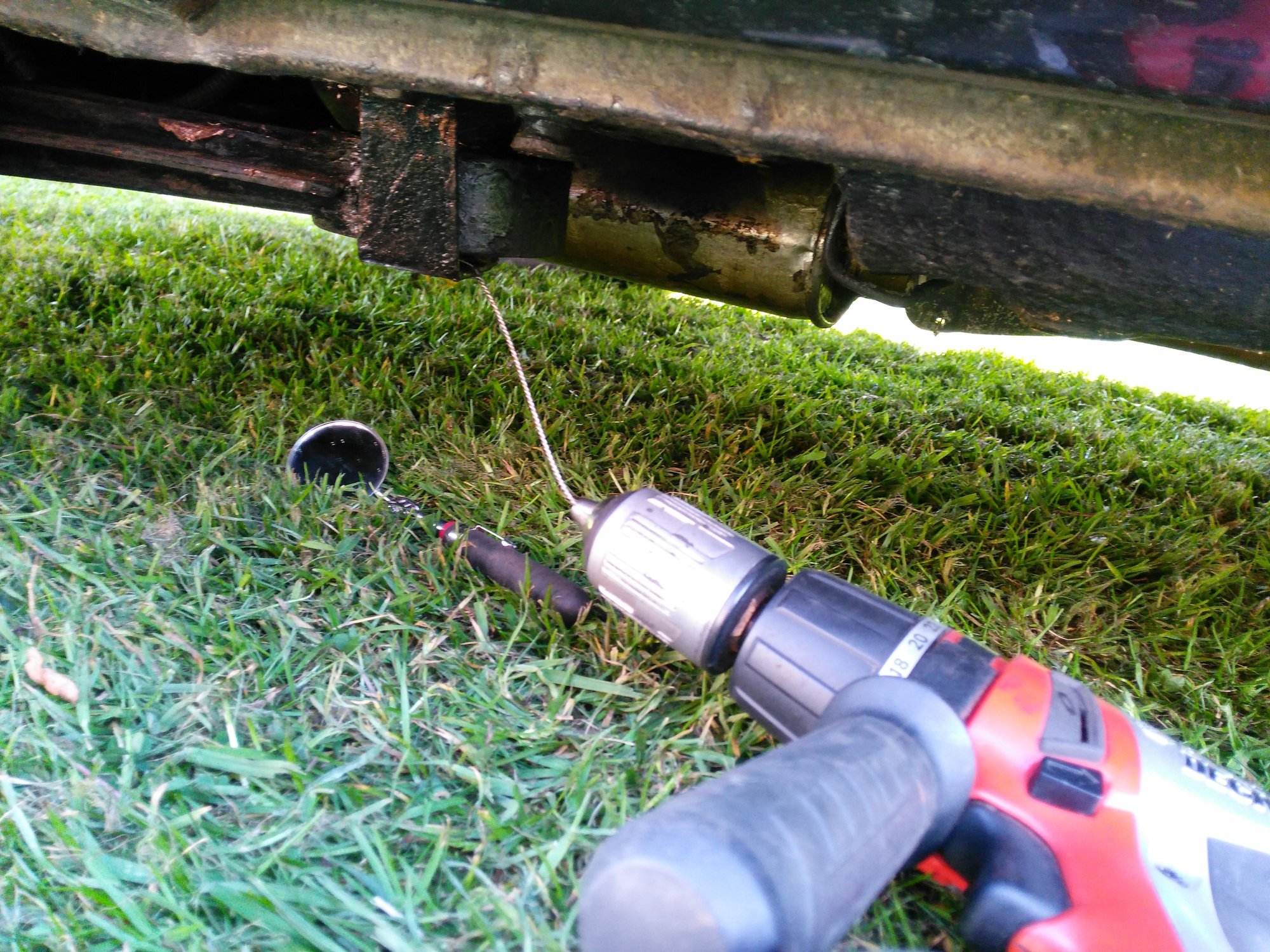

Hi Guys
Got Probs!
The Exhaust Shield above the Exhaust has fallen down on top of the Exhaust
Any Ideas what I should do and is this a big problem that needs fixing before I drive her, or should I just leave it as it is?
It looks like its made of Tin or something like that
Alex

Is it the large vaguely triangular one above the propshaft behind the gearbox? If so, it is fixed to the body by self tappers that themselves are through thin strips of the heat shield metal that stick out from the main shield body That are screwed into the floor of the car. Either the self tappers have given up, or more likely, the tabs have broken off.
Sadly, you need to undo the propshaft BRAIN FADE, meant to undo the EXHAUST again to get the sheild out and examine it and fix new tabs to it (eg thin steel pop riveted to the shield).

Its over the Top of the Rear Silencers just in front of the Cage and made of Tin, is that the one you mean?
Just done a quick edit as I've found a Photo that shows it just to the right of the Silencer

Are you using a drill to twine your safety wire?
Old May 5, 2021 | 02:12 PM
orangeblossom's Avatar
Joined: Feb 2013
Posts: 17,809
Likes: 3,945
Hi Vee
Yes I am
Should I be doing it some other way?
It seems OK to me

Don't really want to put more than 10 or so twists per 25mm in the wire - depends on the gauge of the wire - 6 to 12 twists max, first twist should be within 5mm of the fastener on the side best desposed to prevent slackening - generally the first loop and twist is done by hand to snug things. There's a YouTuber called AgentJZ that works on jet engines that did a whole vid on wire locking.

Don't really wan't to disturb it now as its easy to keep an eye on, as my top priority is to get her back on the road asap its just that Summer hasn't turned up yet, its been raining!

OB, This one?
Also I had brain fade, as it is the exhaust, not the propshaft you need to remove to get it out. And it is screwed in place, no tabs (that is on the smaller ones each side in front of it) so my lasy post could not have been more wrong! Sorry.

This Shield is made of Stainless Steel, so pretty much impossible to drill and so I'll have to Jack her up to take a closer look
