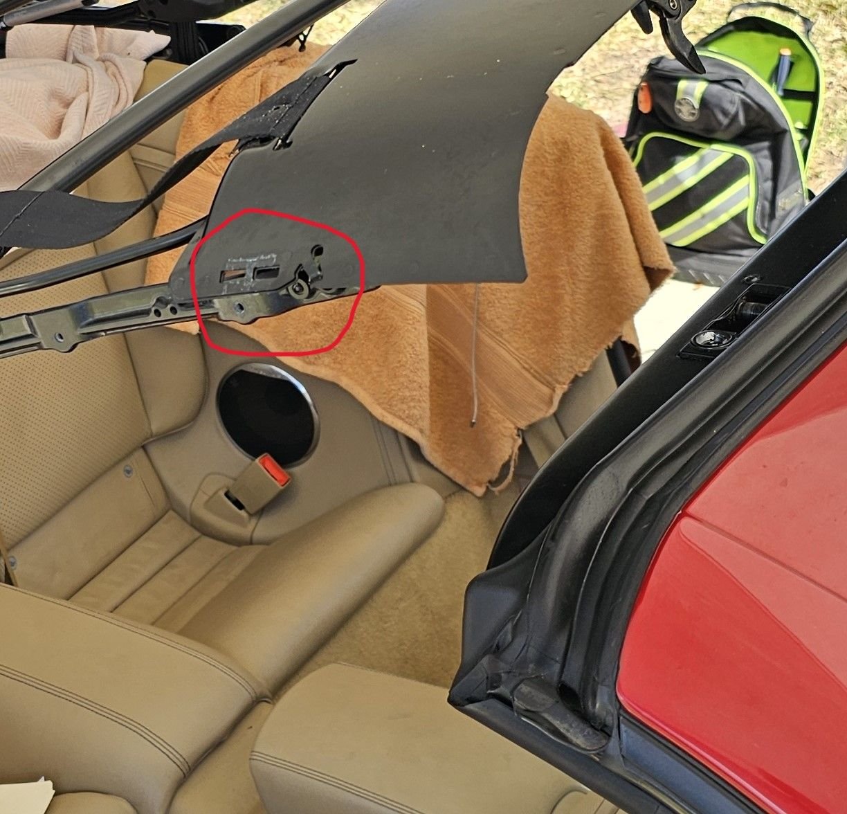

As it goes the clamps for the cables at the front didn't have enough padding as compared to the original top ones and obsereved that they were starting to show a mark in the outer top.
Essentially an easy repair (just had to remove the overhead trim piece and the weather stripping in that first segment of the top and nade the modifications:
1) bent the tips downward so they were flush and smoothed the edges.
2) added an extra piece of Gorella black fabric tape over them. Similar to what was on the origanal factory top had.
With that side I revised the procedure to include those details.

While I didn't photo the marks you can sort of see the marks @ the arrows and the general area and the location of the clips on the other picture. It is approximately 5" back from the fron edge of the top and close to the side edge of the top. you can see the adhesive left from the cover Hope this helps.

This would be directly on top the area that the roof cables attach.
