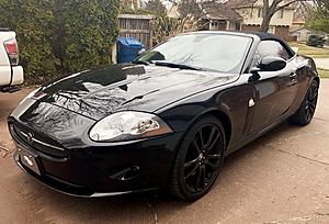

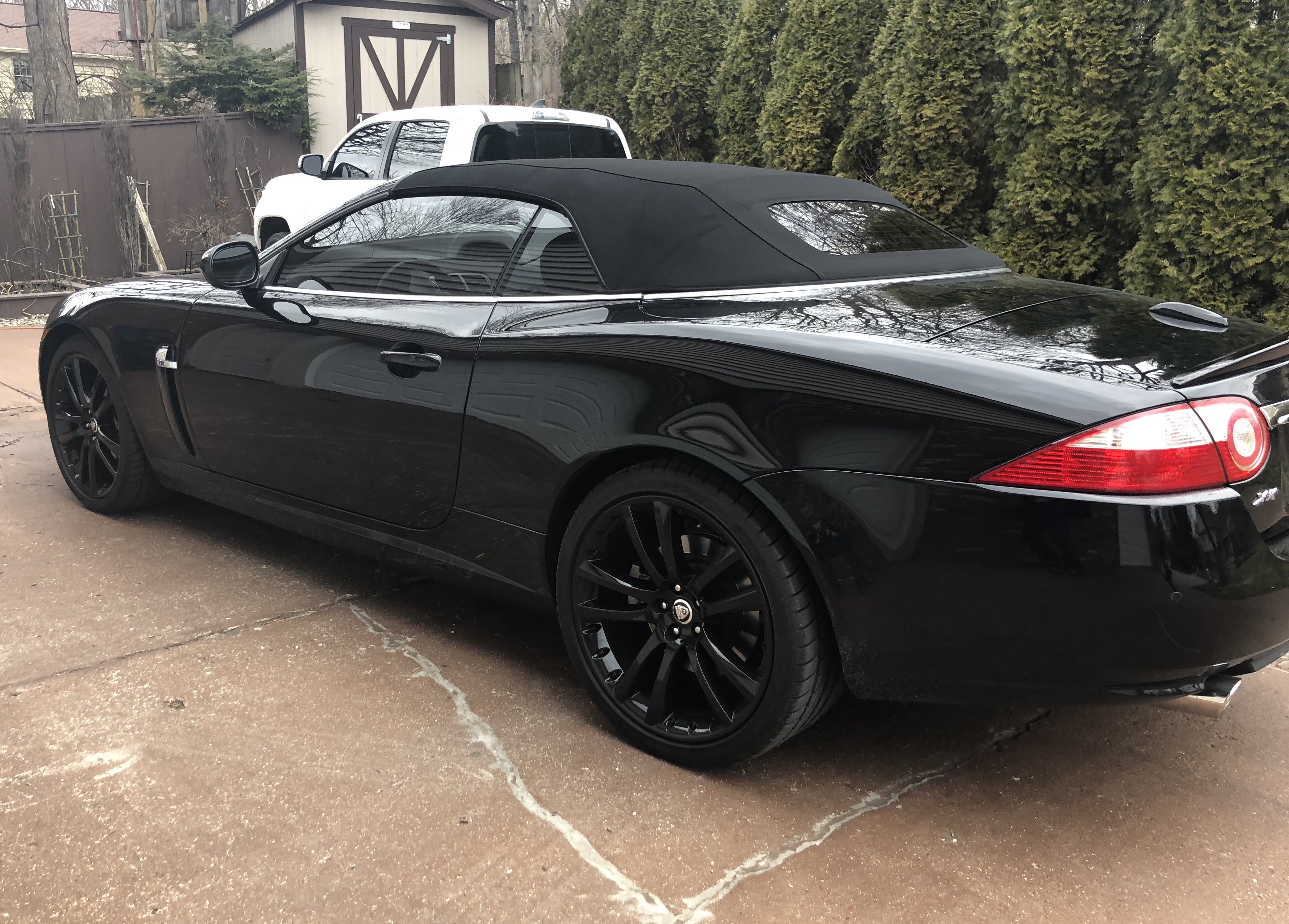

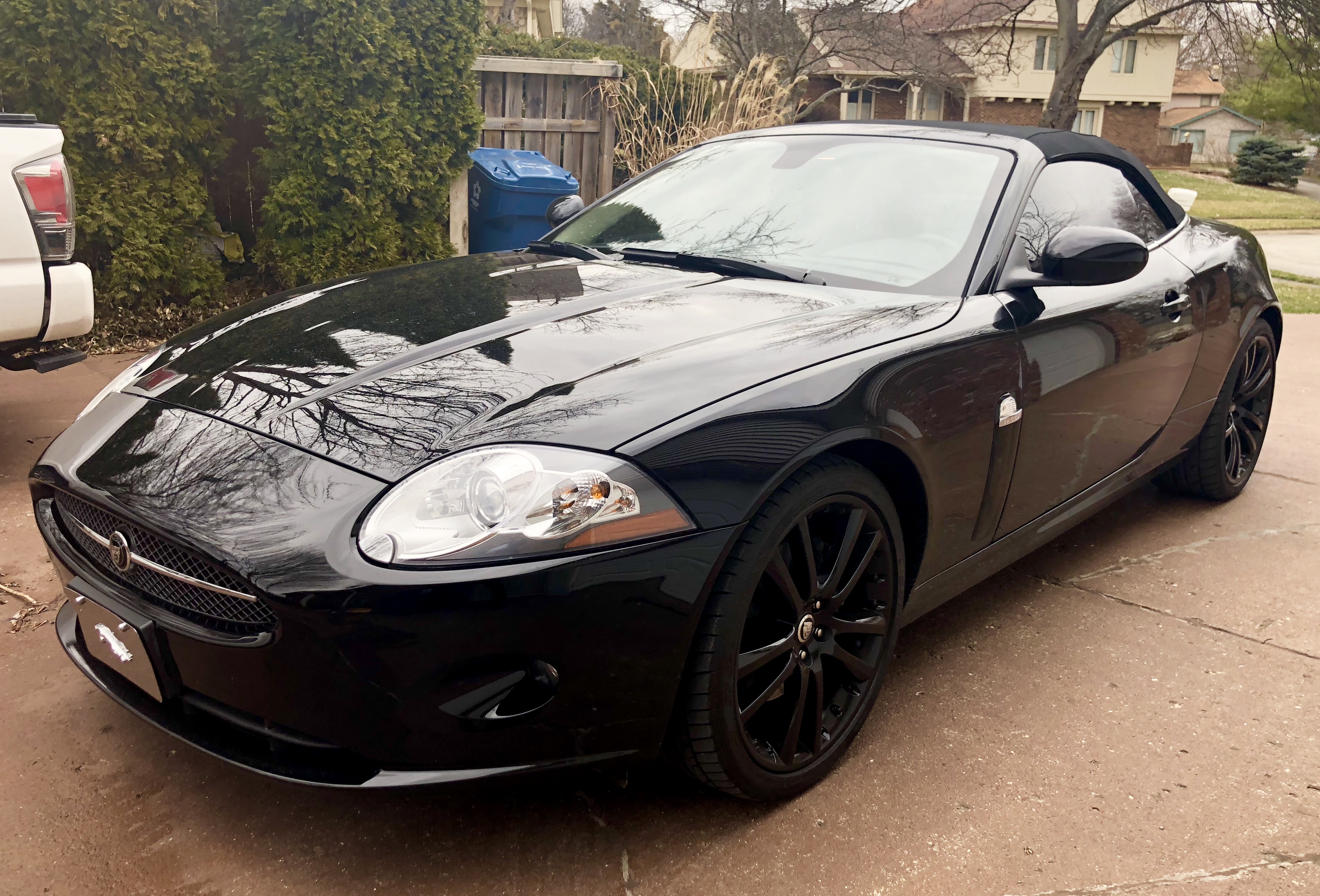

Ok Guys,
I jumped back into the Jag world after my 2010 XFR, and my 2014 XFR.
I now have a 2007 XK convertible with 16,000 miles on it that I just bought. One owner. Last service in 3/2017 included Radiator flush, Brake fluid change. Battery changed in 2013. Drives like a new car.
I am going to store it in Florida and plan to drive it <500miles/year.
So...what maintenance would you guys do? Nothing to follow as this is a 10yr old car with so few miles.
I'm doing battery, Oil Change for sure.
Fuel injectors?
Differential?
Timing belt?
Plugs?
Thanks in advance,
Mark

Nice looking car. XKs love to be Driven. 500 miles per year, IMO is just not enough mileage.

Noce car! Make sure u drive it more. 500 miles is way to little
