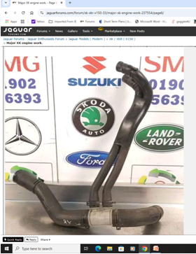

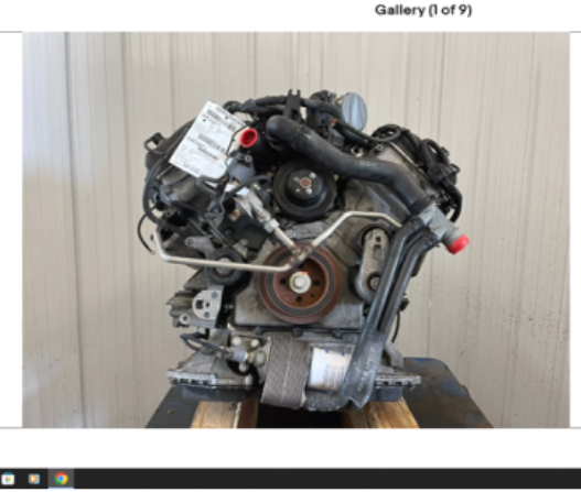

I''m looking for forum knowledge and experience with these oil cooler and adapters on my XK. I had a leaking rubber hose on the "oil" hose fitting going into the heat exchanger on the filter adapter, which I have Temporarily repaired by adding additional hose clamps, but need to replace the hoses. The repair manual shows a different configuration, and I assume that design changes occurred for later aj 34 engines and turbo charged engines. I think the way this works is that when the oil is warm, it just circulates thru the filter, then the air to oil heat exchanger, back inside the engine to distribute where it is needed in the engine. However, the two oil lines off the adapter housing are inlet and outlets for oil that go up via hoses to a fitting in the coolant lines, that I assume is an water to oil heat exchanger, that I also surmise is for "cold oil" heating for cold starting conditions. Can anyone confirm or offer an alternative explanation for this? Secondly, can anyone provide a part number for dual hoses? Thirdly, these appear to be about 3/4 or 7/8" hoses, which are not standard size. Anyone found a generic source for these that I can use? If my premise about this circuit is correct, I'm also considering just looping the inlet and outlet hoses at the cooler adapter (avoiding what appears to be major effort to access the upper fittings on the coolant lines). THis would negate "oil Heating" during startup. However, this is a summer car, and I don't run it in cold weather. I note that some of the range rovers such as 2005 LR3 have what appear to be identical oil filter adapter housings . As a side note, I got this Jag last spring with no maintenance history, did suspension, fluids, and about everything else for a 75k mile vehicle, and enjoyed an additional 7k miles last year before winter layup. The oil leak appeared after this spring oil change with 5w30. This is my third jag, I did head job on my 87 xj6 (terrible head to remove with the long wetted head studs) and also did head gasket and valves on my 94 4 litter xjs, which I still use at 174k on the clock. Thanks in advance
picture of hoses form 2020 engine rebuild on this forum
similar engine, with two oil hoses connecting to device in coolant hose.

The top pic isn't from a 4.2 NA. Where's the link to that pic?

There is an extensive thread on this forum from 2020 about a gentleman that did an extensive engine overhall following engine overheat and valve failure in the uk. Apparently, a private reply identified the part number, as it is not in the thread. This image was part of that thread. It is inverted (180 degrees) from the hose orientation shown on the engine in the second picture. The engine in the second picture is an ebay engine that is identical to my 2007 configuration, that shows the two hoses going up to the coolant line.

OK you're looking at the lower radiator hose assembly. 6W838286AD. Pull it up an eBay and you'll see a few of them, mostly from NOMA Auto.

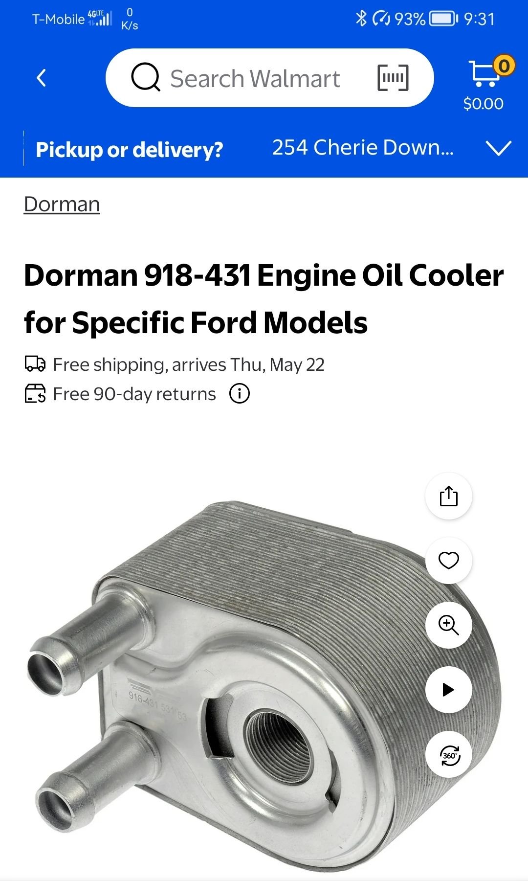

That seemed like the obvious route to me. I found another source for the cooler - apparently Dorman now makes the same Ford cooler for about $46!
