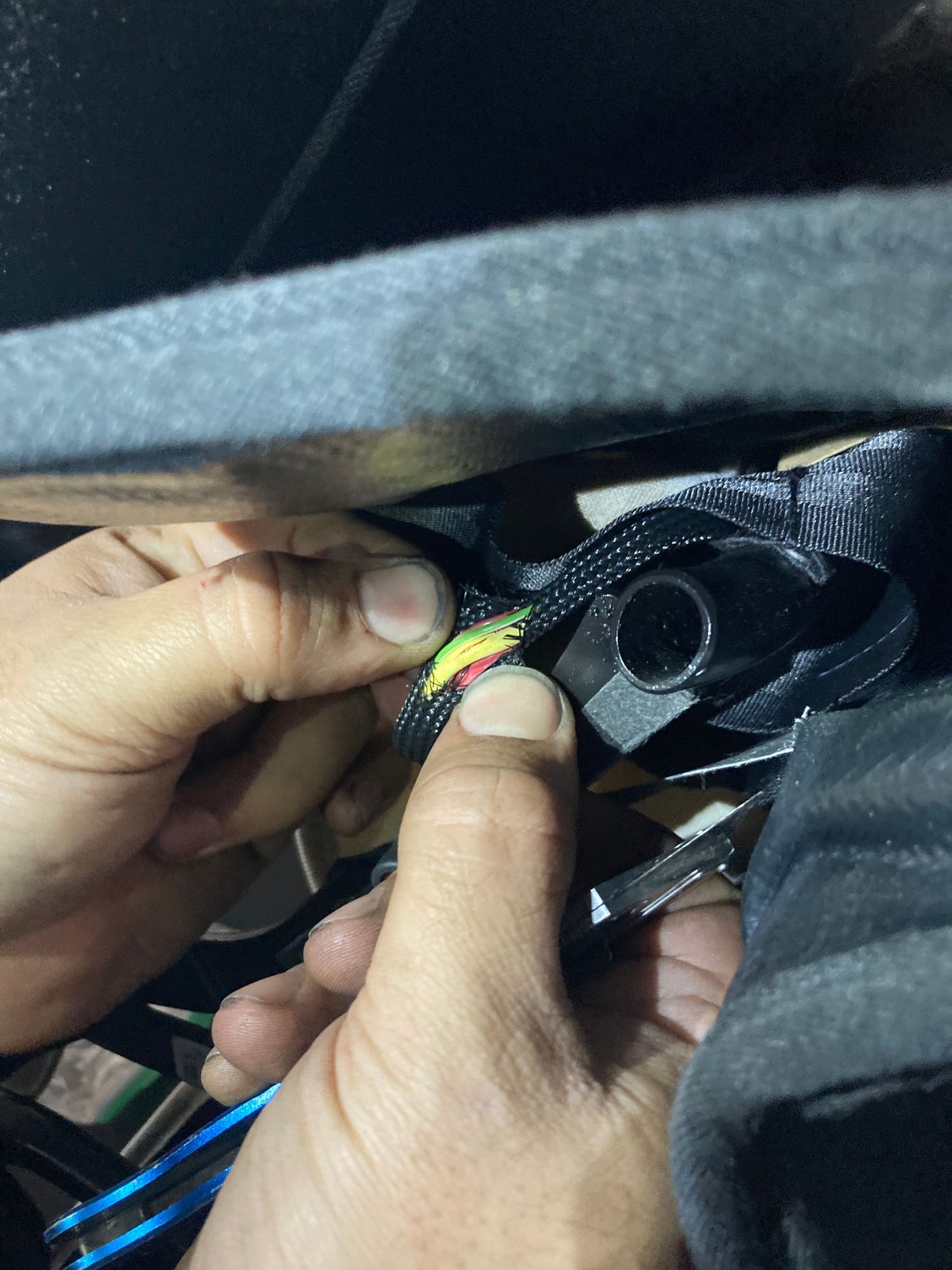

This is the trouble spot on the driver’s side. Right here the harness bends and straightens when the top folds and unfolds.
You will have to cut and pull back the nylon outer cover to inspect the wires…

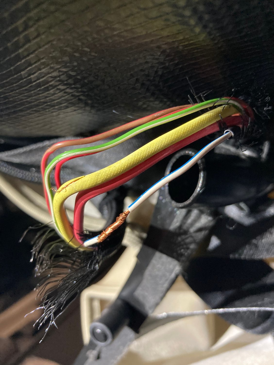

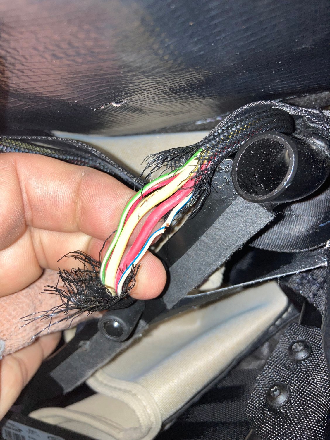

Once we were in there, the broken wire was easy to spot!
We stitched the conductors back together and soldered the bundle.
Then some shrink wrap and electrical tape to finish the job, and the top was working again!
