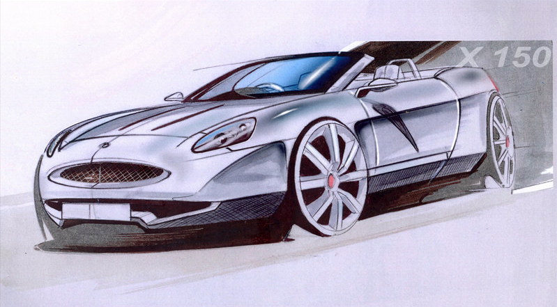

First of all, I would like to thank many of you who have, and continue to be so helpful and instrumental in my modifications. Invariably mods are a personal exercise in expression but it is also my attempt at interpreting what the XK should look like, starting from their own design sketches. So it was important to create simpler lines, emphasizing clarity of line and form, suppleness and yet restrained muscularity. This meant reducing details, embellishments and gaps which invariably led to lowering the car, installing a new mesh grill, some plastidippig, etc. Here's a list of what I did, and happy to offer any further advice in addition to what has already been given.

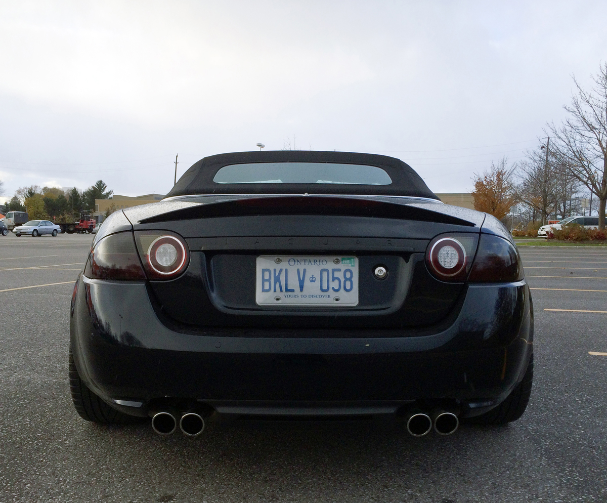

5. rear Jaguar emblem - plasti-dipped the chrome emblem, but will likely have it painted in celestial black to match the rest of the car.
6. removed the XK and R emblems at the rear, and relocated the R emblem to the front. I think I will add a R emblem back to the rear.

10. rear lights - I also had the rear lights lightly darkened with a film to emphasize the circular shape of the reverse lights which I always found an interesting and distinguishable feature of the XK.
