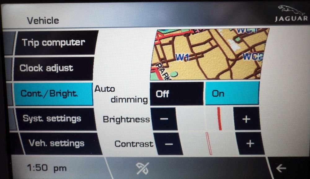

Did yer check the display settings?

^^ Thanks, McJag. That was a good suggestion. I checked (and reset mine to max brightness) but it unfortunately did not affect the center instrument cluster display. It also didn't make any difference if the auto dimming was off or on.
I also have the brightness knob that's part of the trunk button/gas cap release button group turned all the way up. It doesn't seem to do anything when I turn it up or down. The dim illumination must be something specific to the instrument cluster.
Cheers.

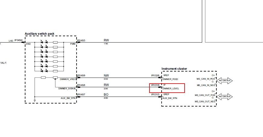

Originally Posted by Catalyst
How is the center panel in the instrument cluster illuminated? Fluorescent panel, LED, kerosene, fire flies? Mines getting dimer & dimer. Have it set to maximum. Can it be changed without replacing the entire instrument cluster? How difficult to do? Can't see didily squat when in bright light. Is this the right place in this forum for this post?
We understand that you are having problems with the ICP, AKA speedometer/tach.
The general illumination is by COB (chip on board) LEDs.
See as similar:
The center display about 2" x 3 may also be replaced as seen in the video.
OSRAM does a great job discussing failure but gives no guesstimate for lifetime. 00102625_0.pdf (osram.com)
If you find no problem at the brightness control (check the voltage drop), we might assume that 2024-2009= 15 years is the nominal lifetime of the LEDs.
Please post your results when you conclusively identify the problem.
best regards,
Bill
