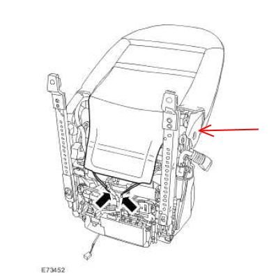

I think the first thing to do is remove the seat rear panel (described in the service manual) to see whats happening in there.

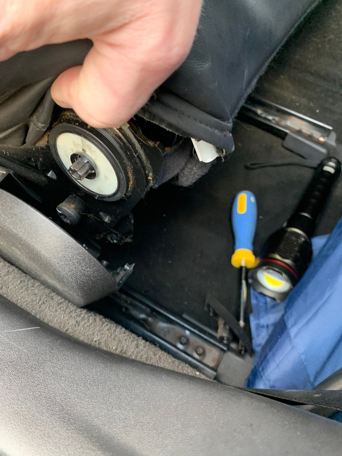

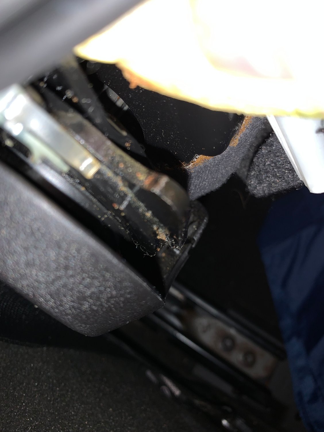

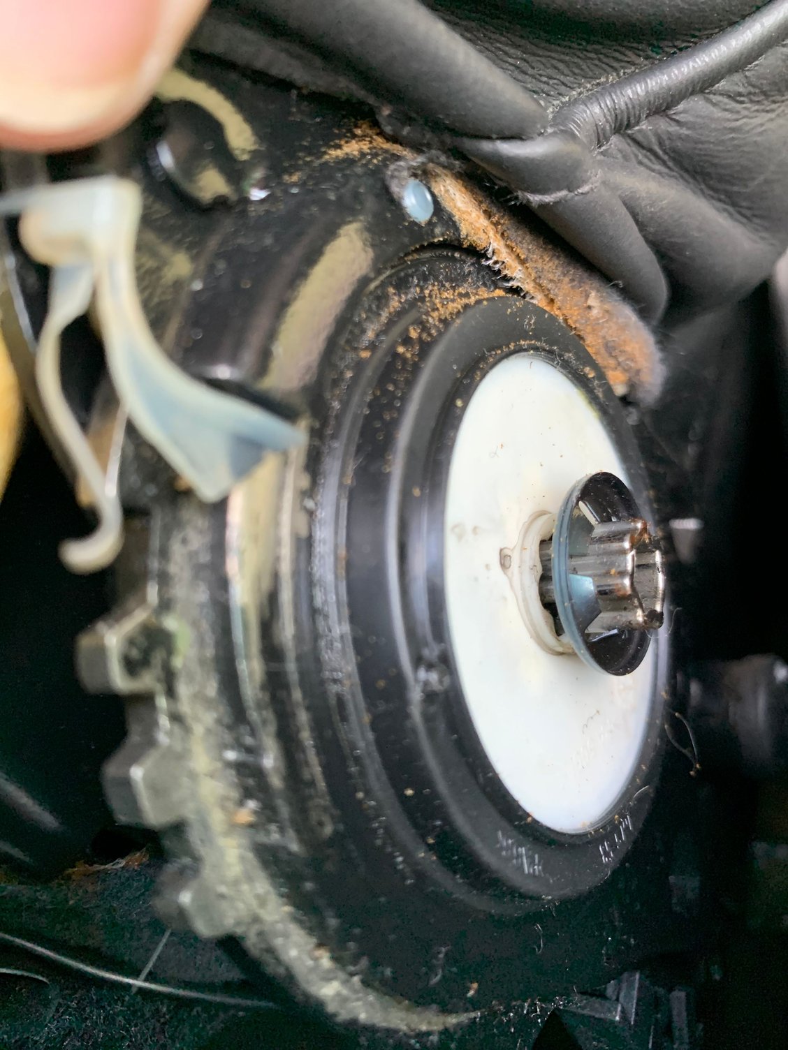

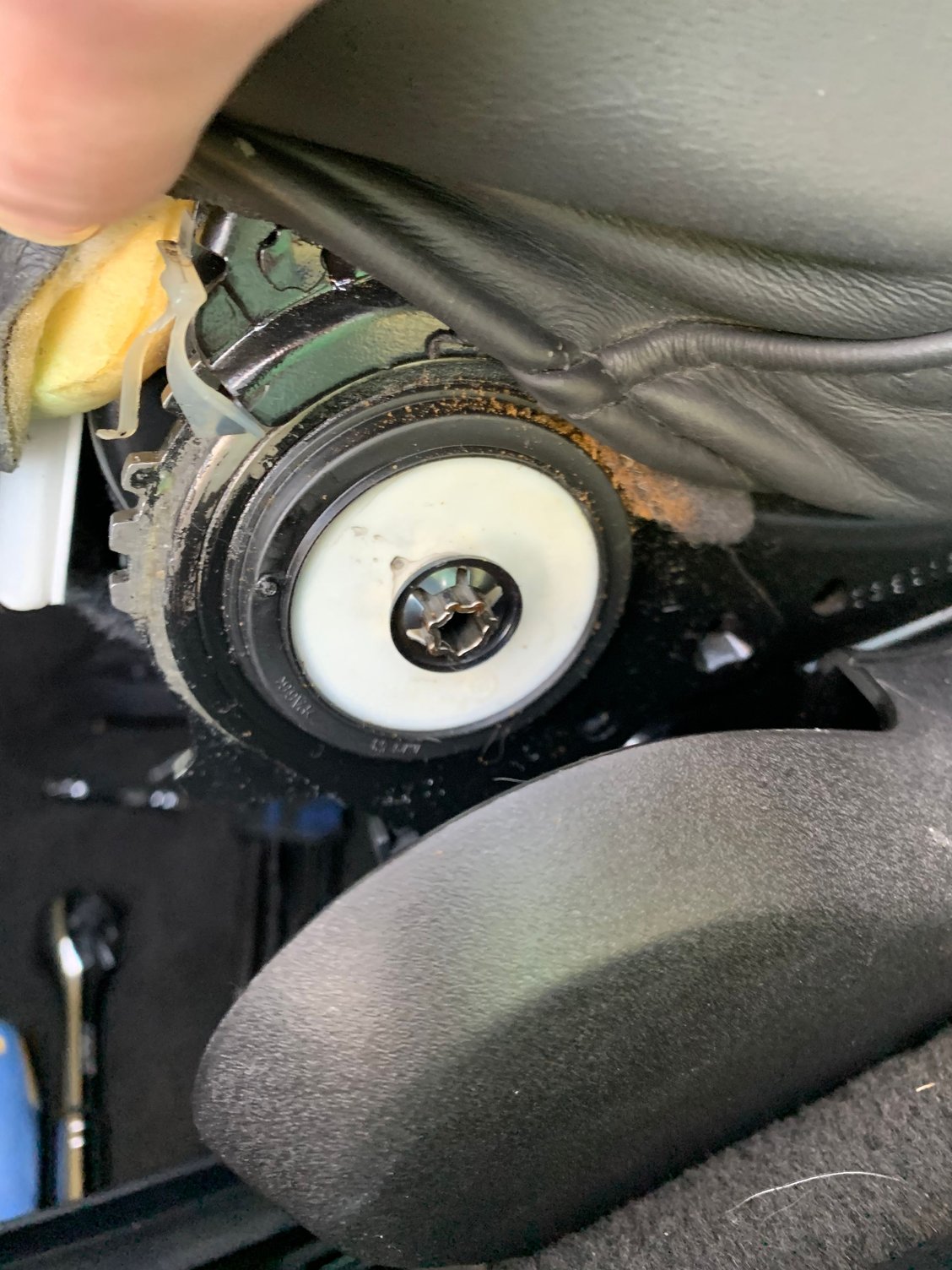

I was able to move the leather out of the way and take pics of the hinge on each seat. First pic is from the driver seat which locks correctly. Second is from the passenger seat the does not lock. looks like there is a broken plastic piece on the non locking seat. Also, the gears seem to be a lot lower compared to the working seat,
I should have time to remove the plastic cover near the hinge this evening and I can share the pics.

Can't make out much there Bill.

Bill, it appears that you're right, that it's a mechanical problem and not a software reset.
Note that Jaguar dealers do not repair broken parts. They are in the business of selling and installing brand new OEM Jaguar parts. Hopefully, you can easily repair whatever is broken.

Ok. I was able to get the hinge covers away from side. First here are shots of the broken seat

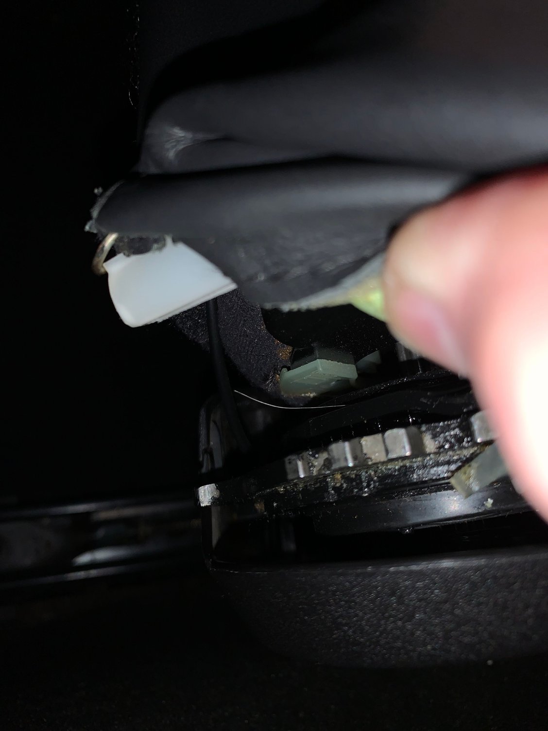

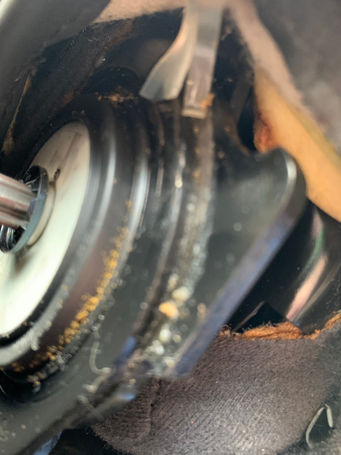

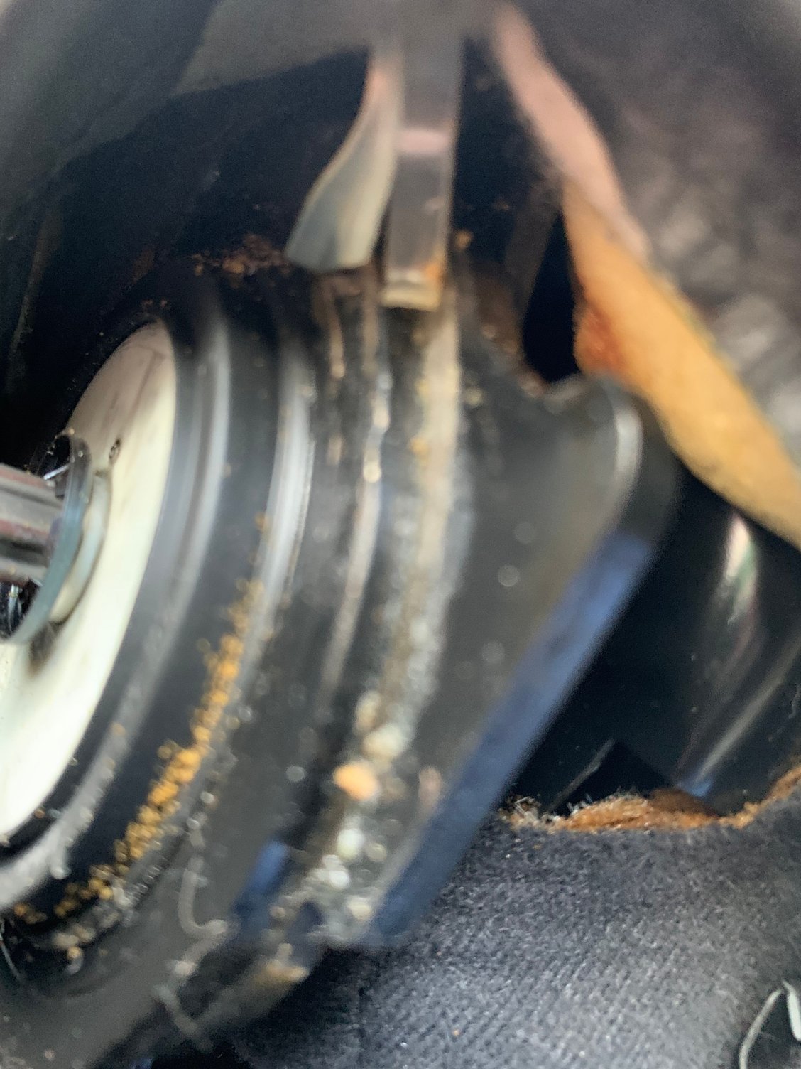

Here are shots from the seat that locks correctly.
One thing I notice is that I see gear teeth on the broken hinge mechanism, on the working seat there is just one tooth that the seat sits on when it is put back in place. I can’t tell from these shots where it locks. That part was not visible to me.

Looks like the seat has to come out for a closer inspection.

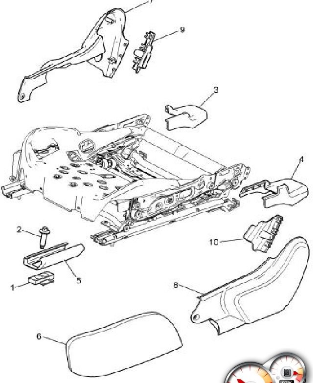

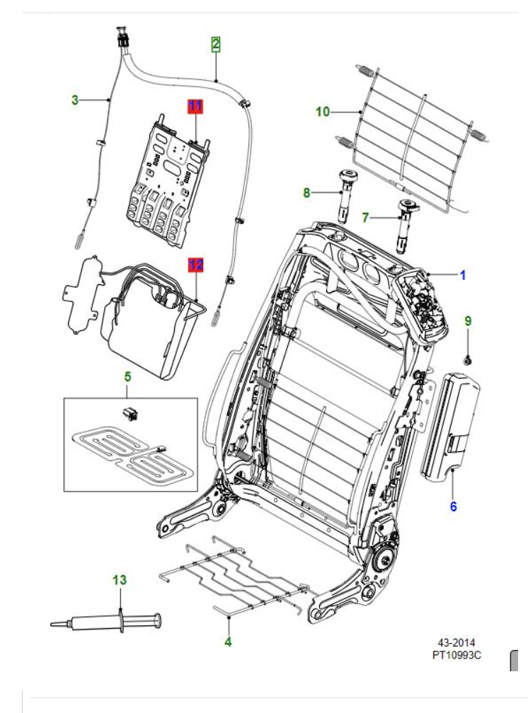

Hope it's easily fixed Bill. Not sure what replacement parts are available - this is all the parts catalog shows:

Thanks! I've seen this parts list, but I could never find the listing of what each part is that corresponds to the number. Do you have that?

That's the list Bill. Some parts are part of an assembly made up of pieces that aren't available individually. Like the throttle body hose (a five dollar part) that is only available with the connecting T piece for over a grand. Even that T piece assembly ain't worth over $50. Grrrr.

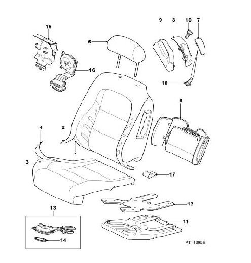

Old Mar 15, 2024 | 10:21 PM
billqs's Avatar
Joined: Mar 2019
Posts: 189
Likes: 61
From: Birmingham, Alabama
I got this from my local Land Rover Dealer and Jaguar Service Center parts department. I think the important is number 2 and 3 which I believe are the two cables that connect the lever to the seat latch. I think the parts lady called it a trigger cable. It looks similar to a window regulator cable which just *might* mean maybe it came loose somehow. I don't know. They don't sale this part on its own. It's part of the seat back assembly which is only $9470. If needed, I have priced a seatback on ebay for $200. First I need to see if the cable is actually the problem and go from there. Unfortunately, I leave for New York for a week in 2 days so this may have to wait till I get back.
Old Mar 15, 2024 | 11:52 PM
kj07xk's Avatar
Joined: Jan 2015
Posts: 5,314
Likes: 2,588
Kind of doubt it’s the cable, because you wouldn’t be able to release the seat back without it. Sounds like a problem with a latching mechanism somewhere in the photos you posted.

You may be right. Kinda 6 of one 1/2 dozen of another as if the cable or one of the pieces of the hinge is broken, I will have to purchase a full seat back from a salvage yard to get the piece I need.
