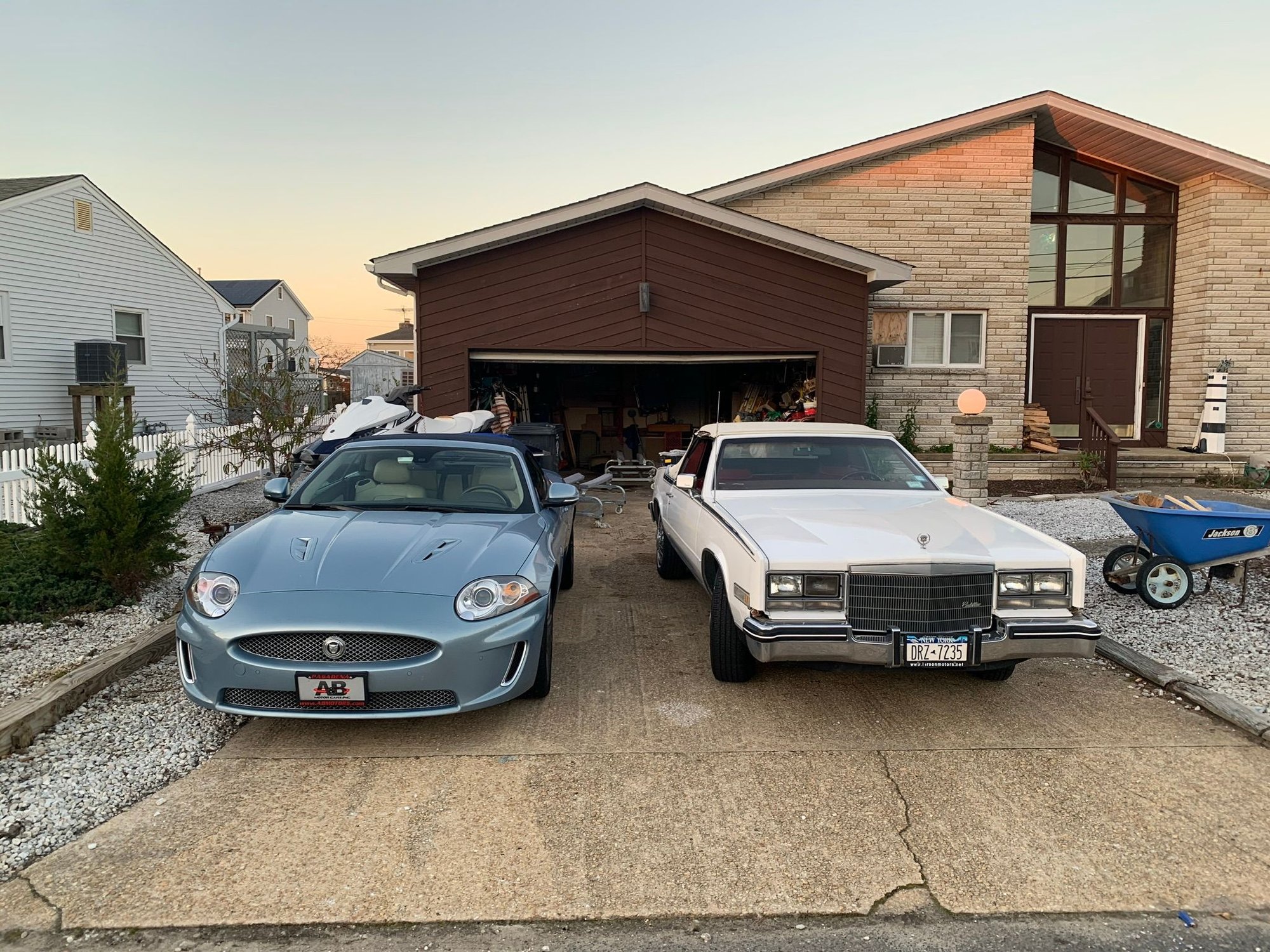

Hey guys, my dad recently purchased himself a 2010 jag xkr convertible. When you get on the gas you can’t really hear the supercharger... i was wondering if anyone’s got any good suggestions for a cold air intake? I haven’t found much info online reguarding a 2010 xkr. Thanks!
