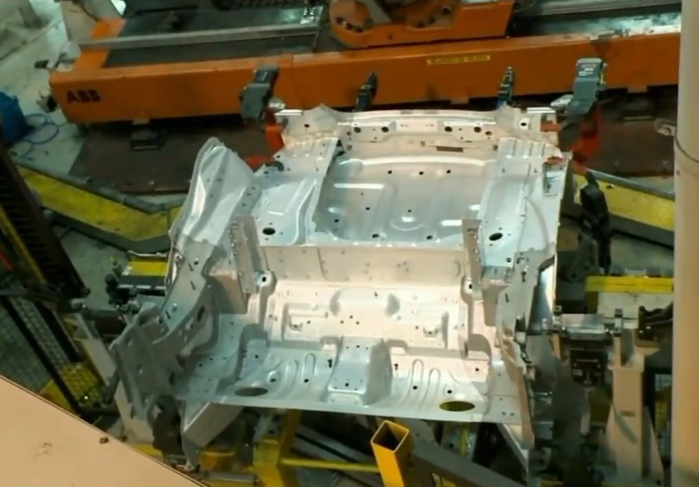

These assembly line photos could help you determine whether the subframe fixing points are all in the luggage compartment or if the front two are under the rear seat.
Thanks graham, looking at the strut tower locations it's defo in behind the rear seats. I'm hoping I'll be able to get at it from another angle but we'll see.
