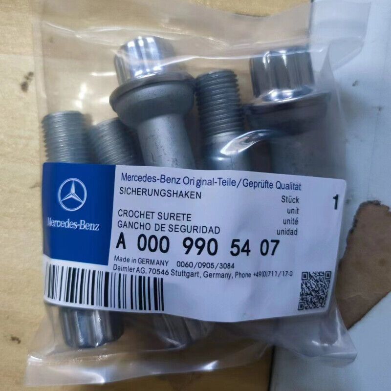

Jaguar is not the only automaker to use stainless-covered nuts. Mercedes-Benz, Volvo, Aston Martin, Lincoln, Cadillac, Lexus, Porsche and others also use them. Here's a set of M-B stainless-capped lug bolts:
