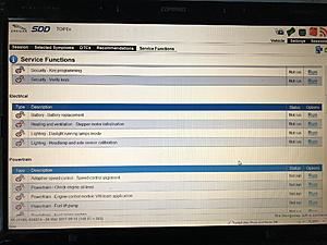

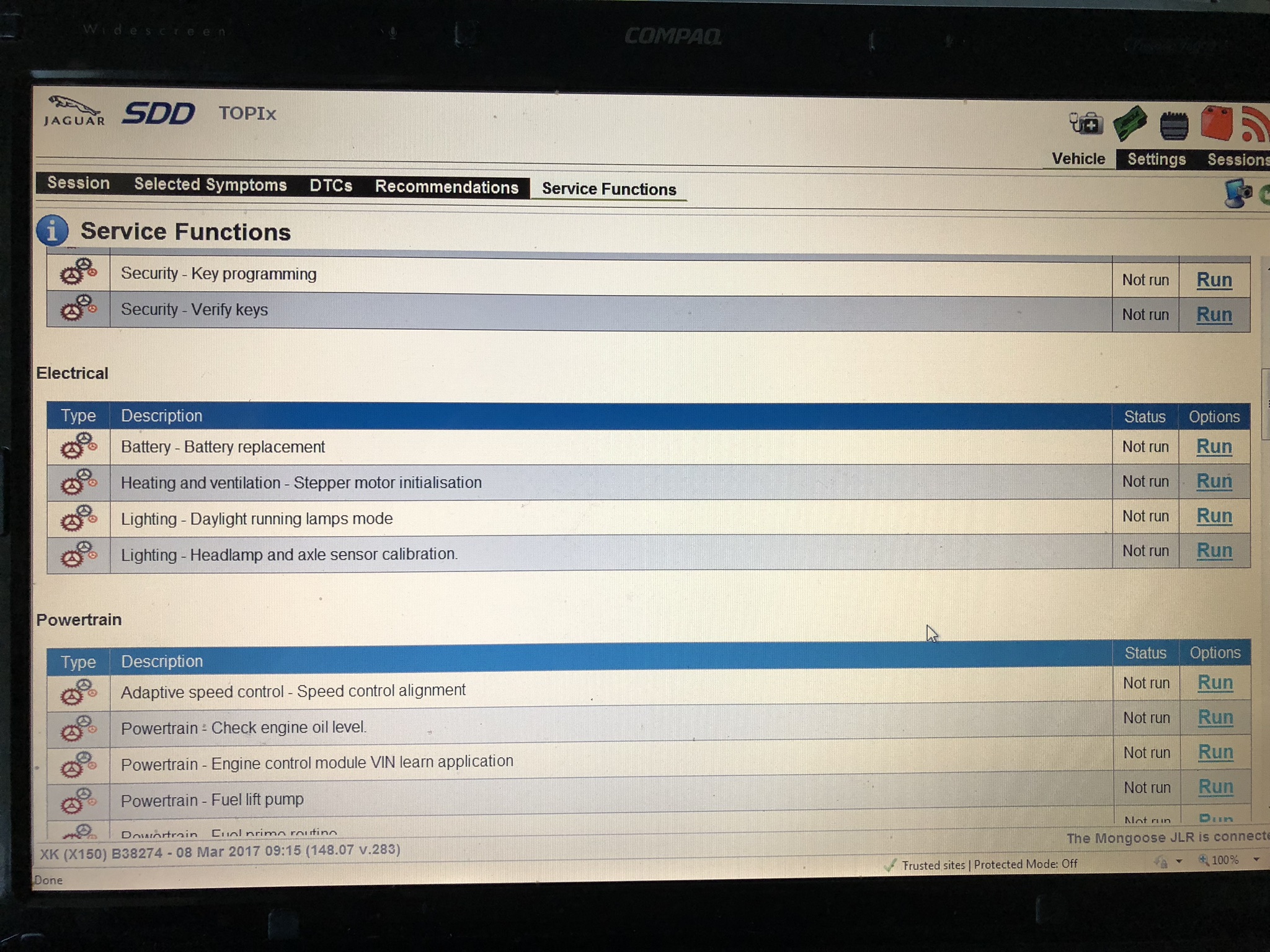

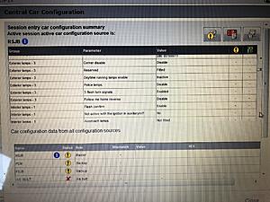

Isn't it just a case of enabling it in SDD?
Attached Thumbnails 2012 Daytime Running Lights-img_0814.jpg   2012 Daytime Running Lights-img_0834.jpg   2012 Daytime Running Lights-img_0835.jpg

According to this dealer no not on US cars

Dealer SDD might not be able to enable that function. Many of the features are locked out for liability reasons on the official factory SDD. An unlocked or hacked version does not have these restrictions. Find an Indy with an unlocked version.
2012 have DRL’s that are on in gear without the headlights being on.
