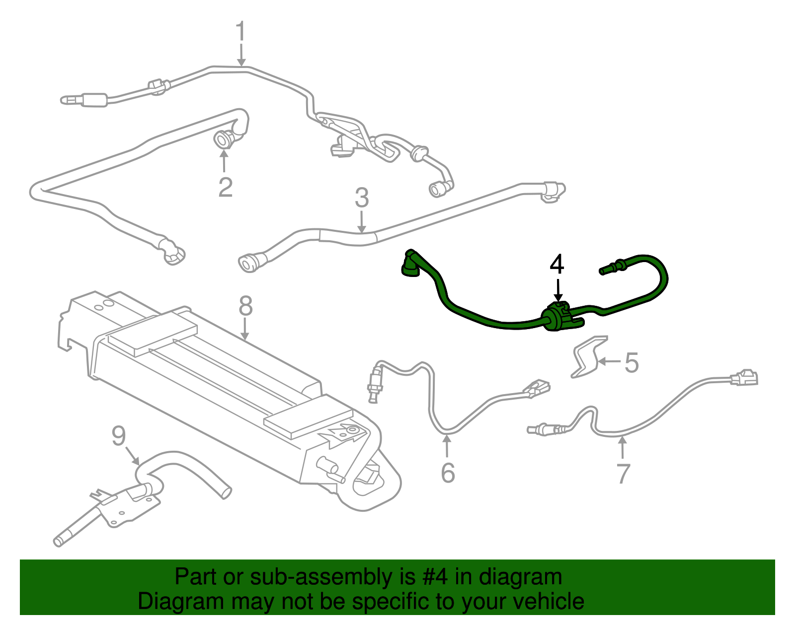

No problem. For everyone, here's the part that was replaced:
Purge Control Valve - Jaguar part # AJ811695
Looks like it would cost $140-150 if you had to buy it.
Pat

And this is what that little sucker looks like:
https://www.ebay.co.uk/itm/Genuine-J...sAAOSwZ~pd3pPD
