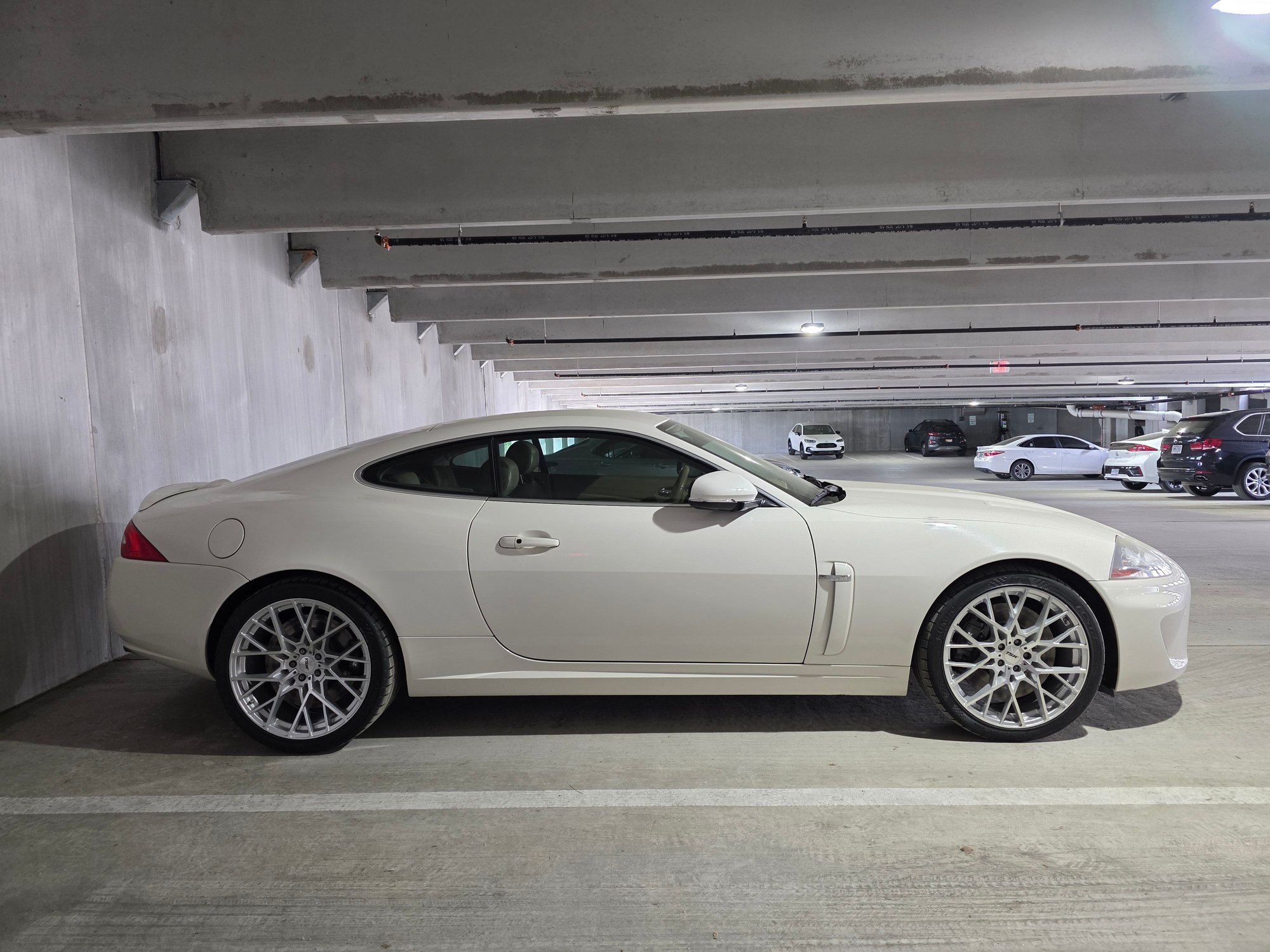

Been running 295s since I bought my car, and I daily drive it. Of course I have aftermarket wheels on mine. 20×10's on the rear.
295s on rear, 255s up front.
