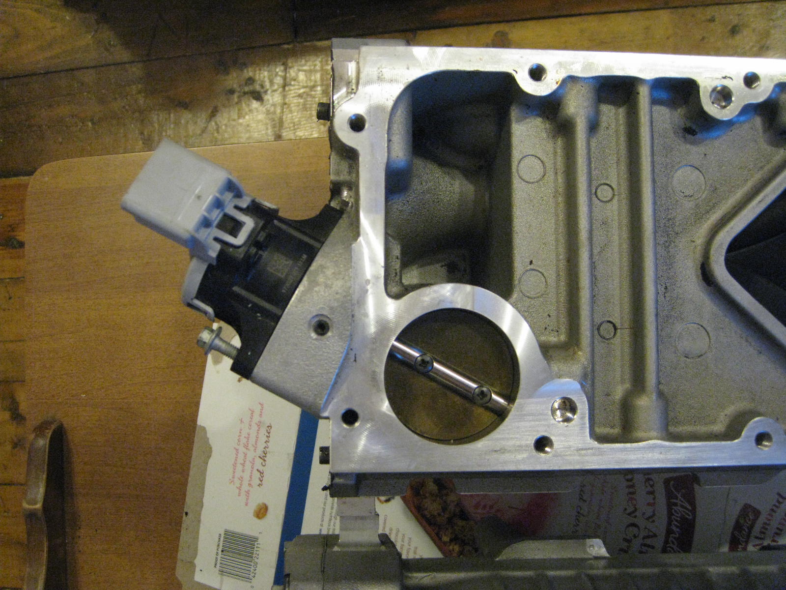

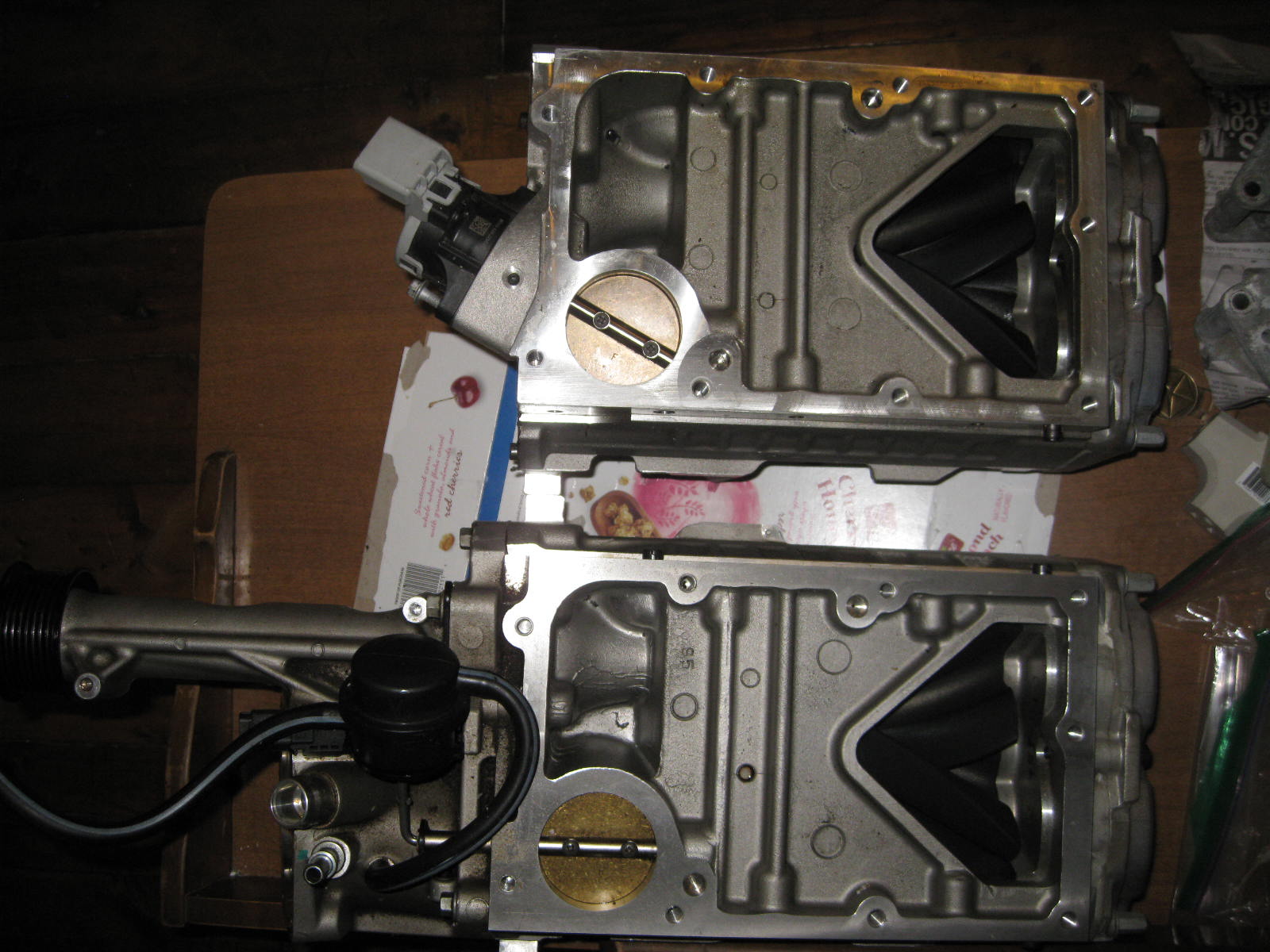

I wanted to add more information to this post. There is a new version of the the TVS1900 superchargers being used for the past year or two. Jaguar and Rover have moved away from a vacuum operated bypass valve to an electrically controlled bypass valve. Just something to think about if someone ever decides to try to swap superchargers on the newest Jaguars. (See images. First image older version next to new version. Second image latest version with electronic bypass actuator.)
As a follow up,of one of the earlier posts, I looked into putting the Jaguar 5.0 TVS1900 supercharger onto the 4.2 block. Very very difficult! The throttle body inlet sits right over the block's water outlet elbow. If would be a great way to go on the STR engine, but much easier to go with AVOS's twin screw upgrade on an STR.
