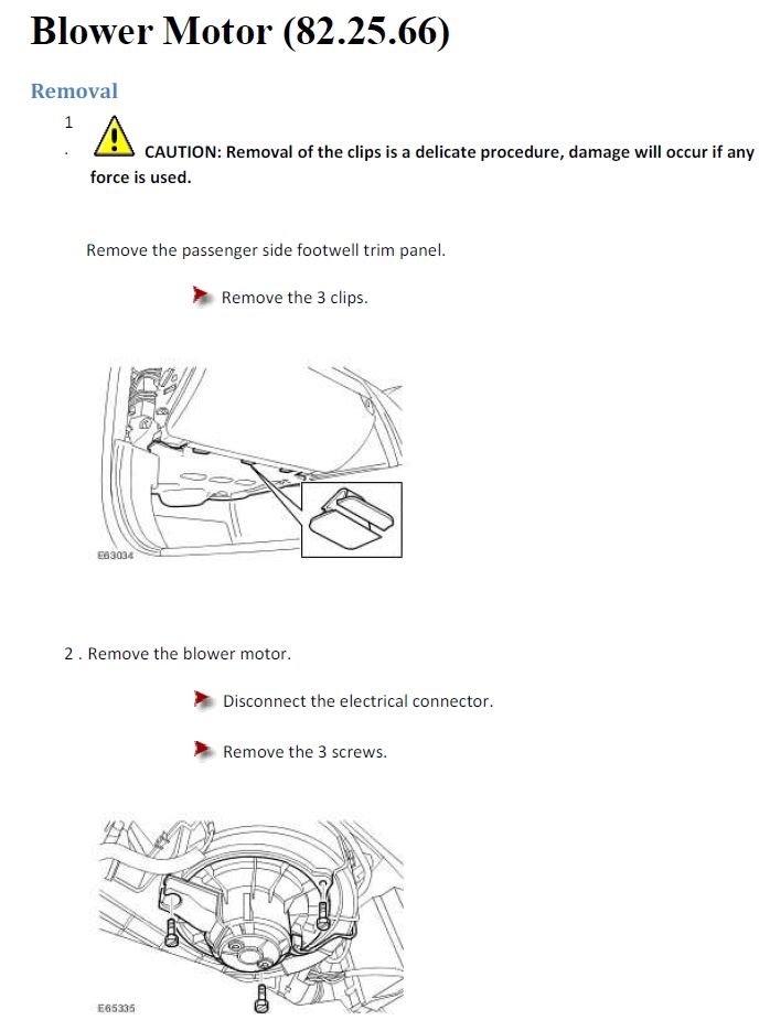

Easy to remove the fan/motor - mine was squeaking - it was particles of carbon from the brushes. Took it apart, cleaned out the carbon and oiled the bearings - been good for the past 2-3 years.

Check to see if you sucked something into the fan squirrel cage that threw it out of balance.

The fan has a fabric cover over it (under the dash passenger side - be careful, the attachments are easily torn) - three screws to remove the fan and plug to remove. You have to be on your back with your head under the dash
I didn't remove the passenger side footwell trim panel.when I did it. - Correction you do need to remove this - I thought it was talking about another item.

Remove the fan - you may not have to replace it.
