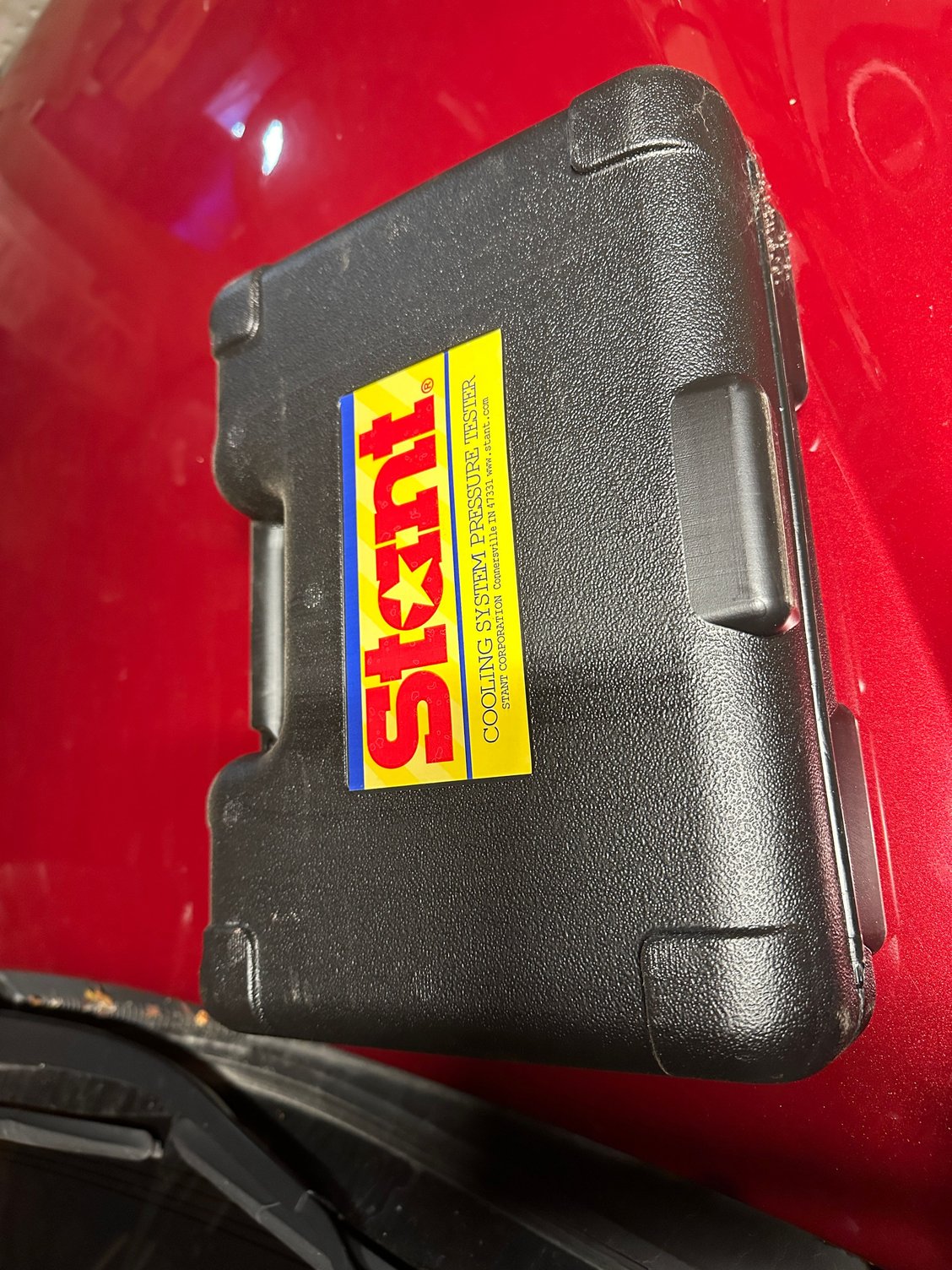

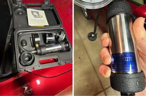

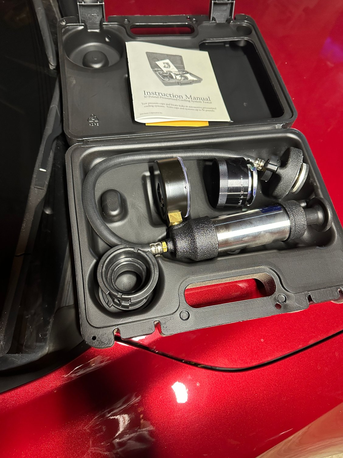

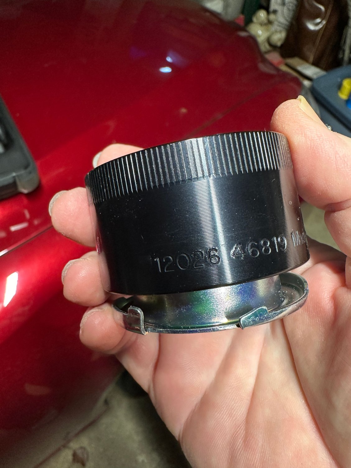

Ok, so my Stant pressure tester is model 12270,
and the adapter is 12026.
Kit comes in a nice box.
The extra adapter fits in the box with the kit.
Here’s the pump, model 12270.
And the adapter, bought separately, model 12026.
Old Dec 15, 2023 | 01:48 PM
